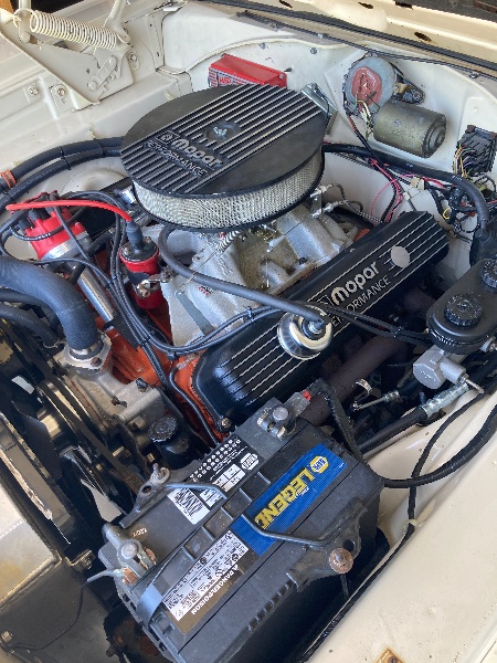

I have a 67 wagon w/440 out here. We've got E15 and so far it's not bad. When I do get into warmer areas, there is some percolation, but it hasn't been a massive issue. The car has just a standard oe style pump on it. Down the road I want to do multi point efi. I would put a better after pump filter on though. At least 10 micron to keep the junk out of the carbs. I'm using a WIX 33032 5/16" inline between the pump and carb. One thing I did on it was put a Mopar trans pan magnet on the inlet side of the filter for rust. Rust and Holley's, using a 3310-2, are a bad combo since its almost impossible to clean out the metering blocks were the crud hides. Not so with AFB's. On the upcoming fresh engine, it'll have 440 Source heads which will eliminate the heat crossover so the manifold runs cooler. If you're running iron heads, you could use the Fel Pro 1215 pan which has blocked heat ports. That helps too. The addition of Ethanol and other stuff, we have the CARB additive in ours too, drastically lowers the boiling point of the fuel. Last I heard, it's 150* on the boiling point for our swill. And as you know, the underhood temps are much higher than that.

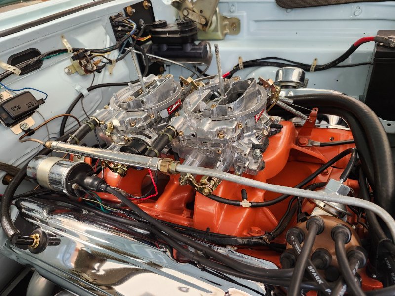

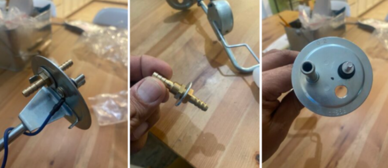

I put a 1/4" tube nipple in the sending unit and fabbed supply and return lines. I also use a felpro 13834 insulator gasket under each carb. Real nice driver.
Like this photo?

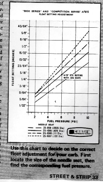

Carter & Edel 4bbl carbs will take up to 10 psi of fuel pressure; but you need to re-adjust float level. The Edel/5.5 psi 'thing' is because fuel pressure controls the fuel level in the bowls & the 'datum' jetting [ not rich, not lean ] is set with 5.5 psi & 7/16" float level.
