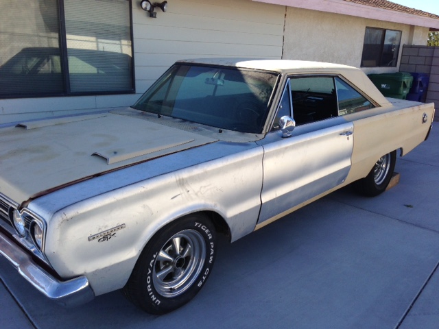

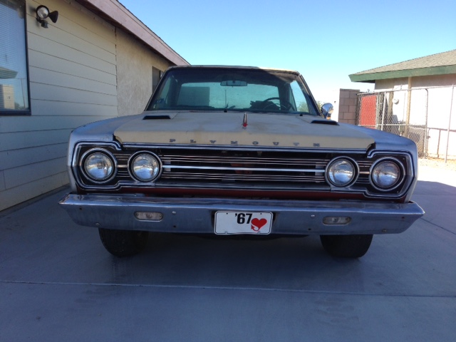

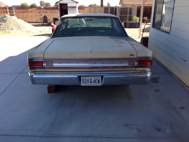

I just picked up a fellow Forum members 67 Plymouth.
No fender tag, no broadcast sheet, just the V.I.N.
"super-bee_ski"

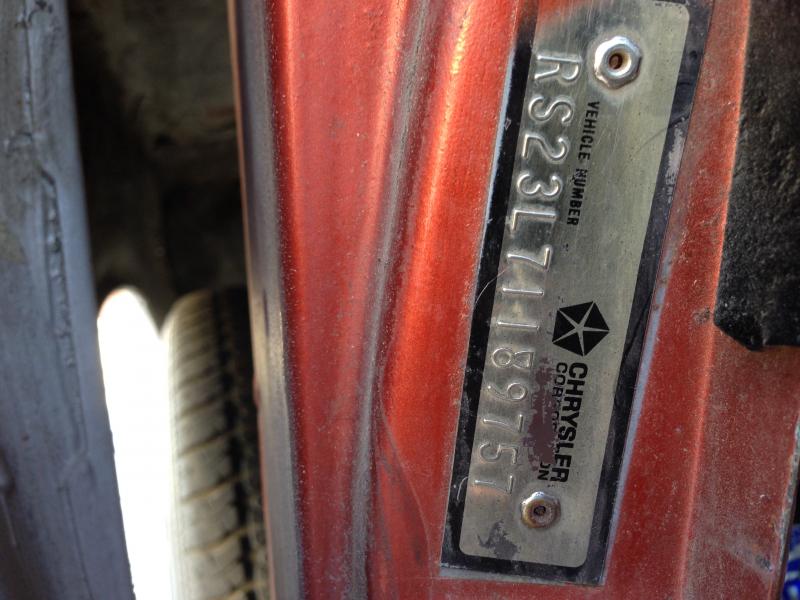

The VIN is RS23
Denotes a GTX
But, perhaps I did not pose the question correctly,
Sorry, I've been making simple errors lateley...
The VIN on the door jam is RS23 so, it is a GTX but it has no fender tag.
I am unable to determine the cars options.
Automatic: YES
It's not a "J" so it is the only other engine option, the 440 Commando...
Other than that, I'm at a loss...

Whats the vin?
It starts out as RS23 not a "J" code for the Hemi but a 440 Commando car.

After the RS23 it will have an "L" if it's a 440 then a "7" for 1967. RS23L7....

Here is the VIN:
