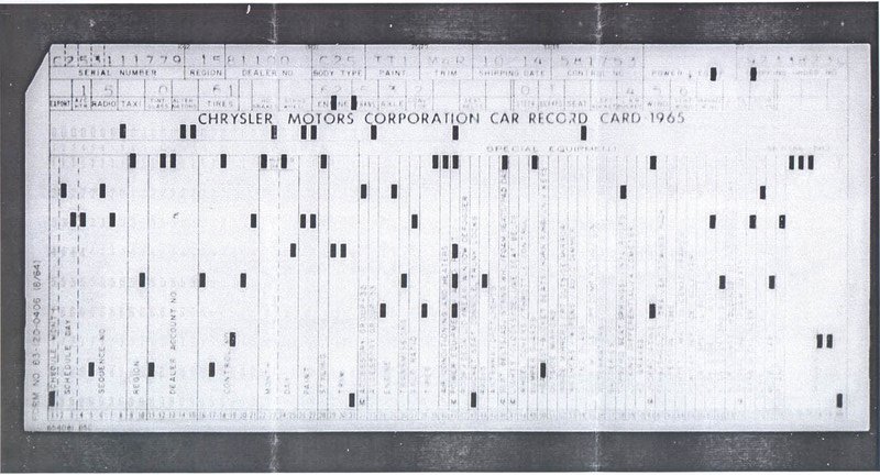

Is it true then that the car "may" have the IBM card somewhere "archived" AND that IBM card can determine the cars options, build date etc?

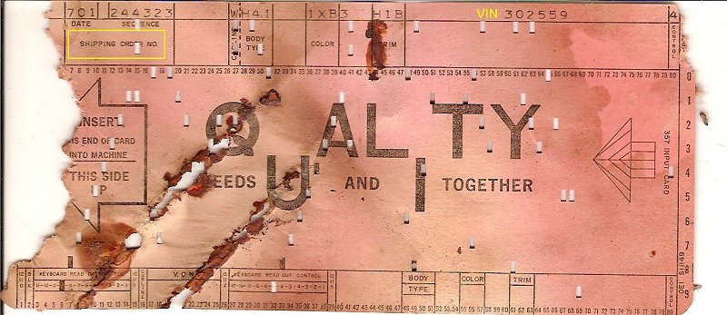

I can not find the IBM card under/over the Glove box nor any paperwork under passenger seat & or rear seat.

1)Is it true then that the car "may" have the IBM card somewhere "archived" AND that IBM card can determine the cars options, build date etc?
2)I can not find the IBM card under/over the Glove box nor any paperwork under passenger seat & or rear seat.
1) Yes. What they will send you is a copy of the IBM build card from a microfiche scan. (see below). You could consider that the master card from which all other documents associated with that car derived. That's why getting a copy of the card is important. It's the initial factory document. Be forewarned...a copy of the IBM card may exist but in some cases they were scanned very poorly and are difficult, if not impossible, to read. Also be alert, the decode the factory gives you may be incorrect. That's what happened with the GTX in the AG Backeast thread. What the buyer got was an incorrect decode from someone not familiar with all the nuances of IBM cards and tags. IF you get a card, there are people on the boards that can decode the card to ensure you got a proper decode. Trust...but verify.
2) Let's not use the generic IBM card to limit ourselves to any one document. The IBM card format was used for other purposes too. In the second case, it was used as an inspection/build verification tool. (see below) This card can be found in cars but it is highly unlikely. It was usually thrown away during the build.
