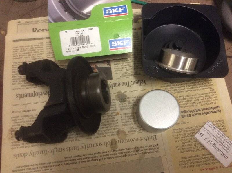

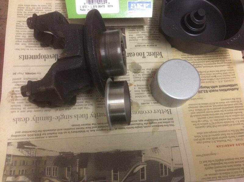

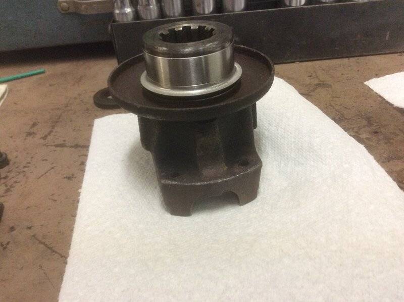

Yoke could have groove from the seal. A fix is a speedy-sleeve.

As mentioned order a new seal with a speedy sleeve, that way if they get the yoke out and it's grooved you already have the right part, and even if it is not grooved from the old seal just toss the speedy sleeve on and install the new seal and your done.
As mentioned the diff fluid can seep out along the inner splines on the yoke and then out under the nut and washer. When they re-install have them fill the void under the nut and washer with RTV silicone and then install and torque the nut....the silicone will help keep the fluid from weeping out in the future.

Speedy-Sleeve is less than $20 US here.
