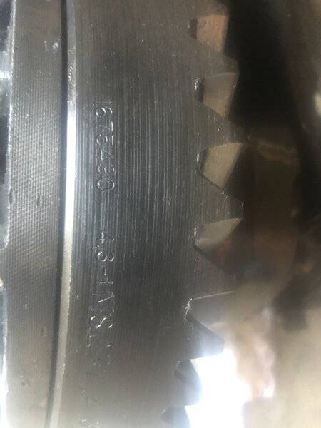

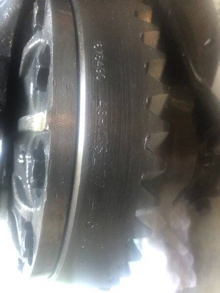

Bought this old race car and this was the rear end in the car. Can anyone help me identify the gear ratio? Thank you!!

You can just count the teeth, and divide the ring by the pinion, to be SURE. But as said above, 4.30s.
An excellent ratio for a small block 1/4 car, or a big block 1/8 mile.
Good score,4.30's are no longer available. I ran them in a Dart for years.It was a good match for my combo at the time.

Thank you!! The whole rear end was in amazing shape for a car which sat for years.
