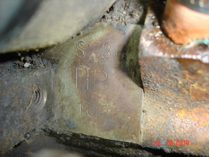

This is suppose to be a numbers matching engine for my 62 polara 500. I see the "HP" but is it a 361?
Could be a 413.
WOW, I can only hope. It`s a 62 Dodge Polara 500 2 door hardtop numbers matching! Isn`t a 413 a rb? This has the marking under the dist boss.
A 413 is an RB. Is there any numbers on the side of the block? Someone will pop up here and clue us in. On an RB the block is 3/4" taller than a 383 or 400
Small Block
Hey look! It's her Sister :grin: Where did you find your numbers? Mine is on a flat boss, on the block, behind the alt. (More pics please of the rest of your car! :yes:

Folks, why do the replies put so much work into what is plain to see. It is a low block, plain to see so its not a 413. It is an S so you know it is a 62 engine, well 361's were standard in the Polara 500. Check that off list, and 36 is the just too close to 361 the standard engine. Plus if you read the first pages of the service manual you know that only the first 2 digits of the cid are stamped on the block.
Mystery solved.

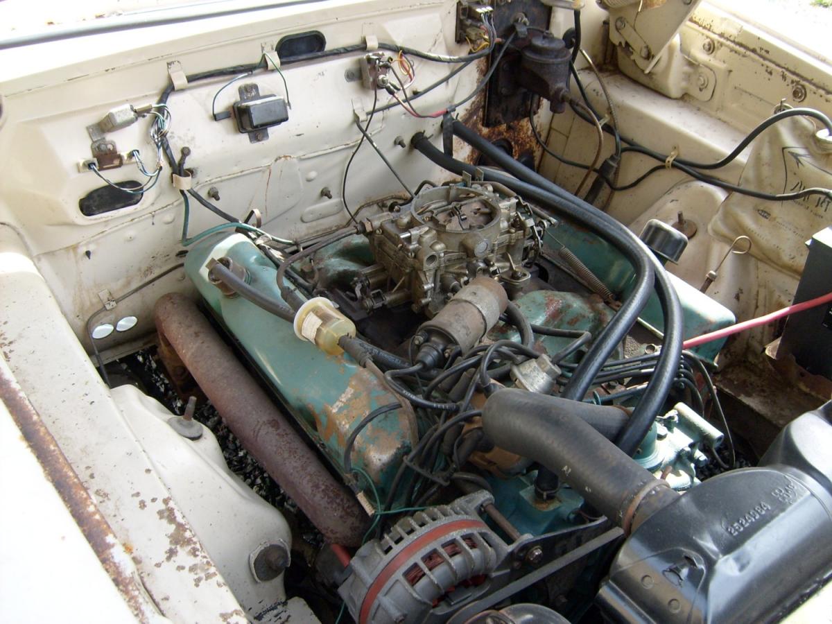

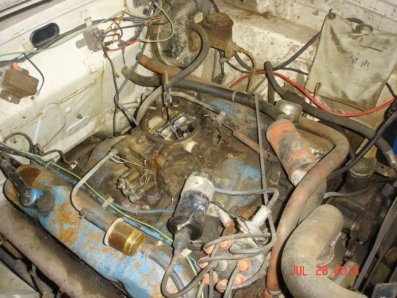

The top photo shows the engine parts are pretty unmolested. The return spring holddown is original. Even the metal fuel line to carb looks correct. Color got changed at some point, no light blue was used. Carb looks original.

For 1962 the standard engine in a Dodge Polara 500 (and optional in the Dart) was a 305hp 361 with 4bbl carburetor. 413's were available with 4bbl carburetor rated at 365hp and 2 4bbl carburetors (max wedges) rated at 415hp.
No 383's until 1963.

My point is given another prime example on the post above "no 383's until 1963" Absolutely NOT true, they were in 62 Chryslers and b body police cars. See page INF 14 of the 62 parts book, that is the pink ones. 413's I guess were put in the Dart / Polara in 62 from some of the reading I've seen but very rare. Yes the late 62's came with max 413, but these were stamped a bit different than the std auto 4 barrel engine. AND THIS IS WHAT THE TREAD WAS ALL ABOUT. S 36 , S 38 , S 41

Holes in wall, whole deal
On to the 'holes in firewall' . Clearly not a factory set of holes. Only guess is some dealer install of a under dash a/c unit. If it were me , in a resto, I'd weld in some metal patch. There were a lot of deal install items in early 60's before standardized option lists. Meant great variability in placement. Antennas are the biggest example. The kit included a template for placement but not always followed.
RE; Golden Lion 383. Odd ball RB 383 came out in 1959 and 60. Not 61. Im sure the dealers had a hard time explaining the difference to customers, and there was little retail gain in having two different platforms.
My 65 Plymouth has a/c and the hole are in the exact spot ,It had the dealer a/c installed ,with the under dash .
