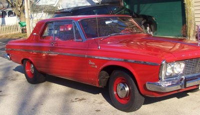

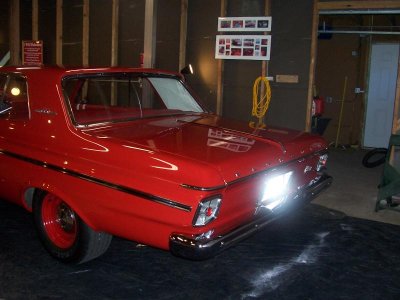

my '63's steel 15in rims are same....:eusa_think:

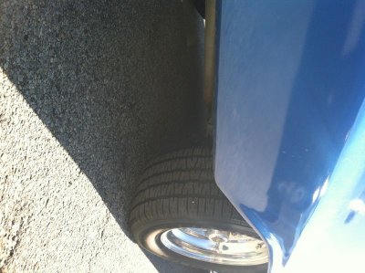

These are 275/60/15 on 15x8's with 4-1/2 in. backspacing. I have about 1/2 in. between top of wheel well lip and the tire; NO RUB!
