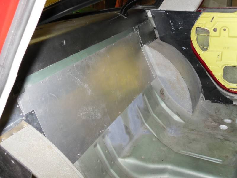

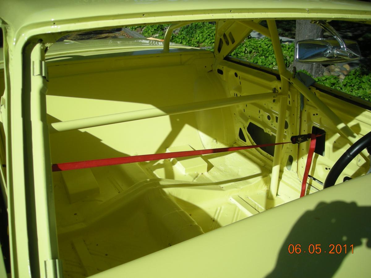

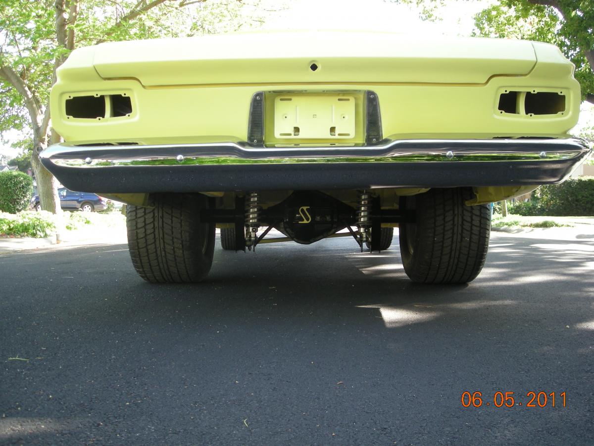

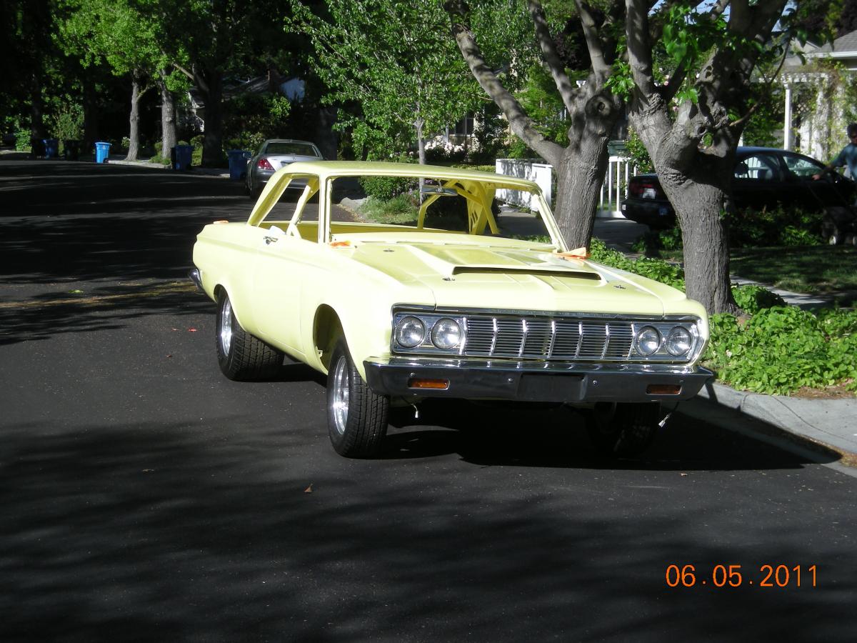

I had the same thoughts as you ! Love the wide tire look ! I went all the way and never have regreted it. The car looks like a TOTAL BAD *** from behind ! The trunk is blocked off with steel plate and if I wanted a back seat I could figure a way to modify the seat to fit. No seat for me. Money is the biggest factor in my opinion. The Dana 60 was custom built by Strange. Tubs I did with help from an experienced hand. 4-Link is from Chassis Works. Look at the pics and really think about it. I spent a ton on the back of the car. Is it worth it to you ? I would do I again in a second ! I wanted someting unique and I accomplished it. When I get it done and on the track lets see if the time and expense was worth it !!

Moose, love the looks of your car, nice work. Those tires give it a real mean look. I see you went with the lower scoop on the hood, which is what I'm looking to do. Who did you go through for that? Or did you get the whole hood? Was it reasonably priced?
Moose, is the v-brace still there behind that block-off? I'm not at the point of deciding on running a seat or not, but I am at the point of deciding if I need to put the V back in my A12 ex-racer.

i have a 65 satellite they split the rear tubs and widened them 10" theres been no mods to back seat all stock hangers in place so yes it can be done look for big bad red pics of my car nice trunk pic
