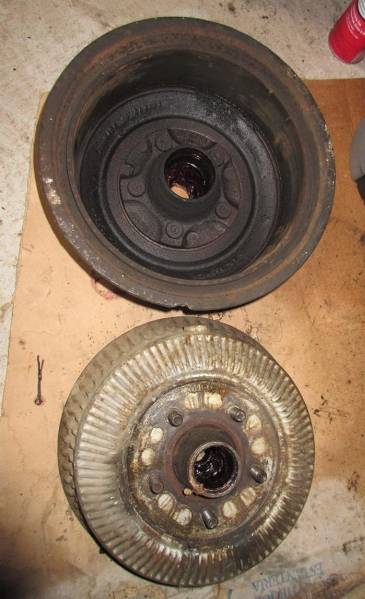

My plan is to convert to discs ASAP, but I was going to buy new drums anyway because things often take longer than planned, and temporary tends to become semi-permanent. But, when I went to unswedge these drums to recover my wheel hubs, I noticed the hole saw overhung the swedges by quite a bit and would be taking material from the drums as well. Maybe I should think twice and ask before ruining the old drums?
I took these drums to O'Reilly's to have them turned down, but they said it had already been done and there wasn't enough material left.

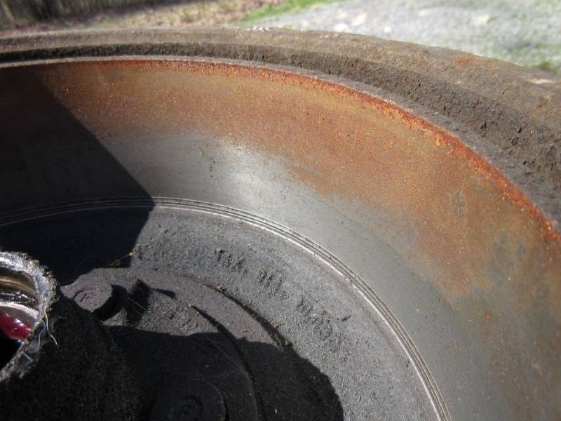

When I last drove the car, the braking power was reasonable. Now it has new shoes, so I don't think there will be an issue with the shoe failing to make contact with the drum. That's my reasoning anyway. I'm sure there's a spec for how worn down a drum can be before it's no good.
I assume I can sand this surface rust down. There may or may not be some pitting underneath.

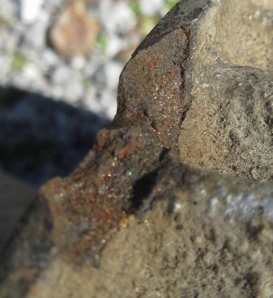

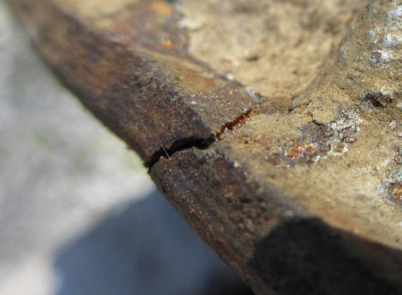

The thing that worries me the most is that I cracked and chipped the edge of one drum while trying to break it loose from an old shoe. I've been told not to let it concern me, but I'm going to double check just to be sure.
Well this is my temporary that I’ve been riding around for about eight years now. The brakes on my parts car looked like they were fairly new (drums turned apparently), so I put them on in place of mine. There are not any places around here that turn drums. The chip on mine does not seem to bother anything, don’t know about that crack( and creeping crud) on your pic.

The rust *could* likely be machined out, but after seeing the last two pics in your post....I don't know why you'd even consider it. Don't be cheap especially when it comes to your safety. Just do it right. The internet "just run it" guys won't be the ones fixing your car or retrieving your body parts out of it after a brake failure....
I wouldn't worry about the rust at all.
The shoes will take that off pretty quickly.
Rotors rust overnight.
The chip isn't a huge concern either.
But the crack could get larger that would be bad.
Clean them up and run them. Keep an eye on the crack. Nothing I see otherwise will interfere with brake shoe contact. Also when turning them it's never about the contact unless they are warped. It's when they are turned too much it's about them heating up, cracking and brake fade cause the thinner they get the hotter they run and could fail.
