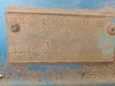

Can someone please decode this

I sure appreciate any info that someone can help with on this.

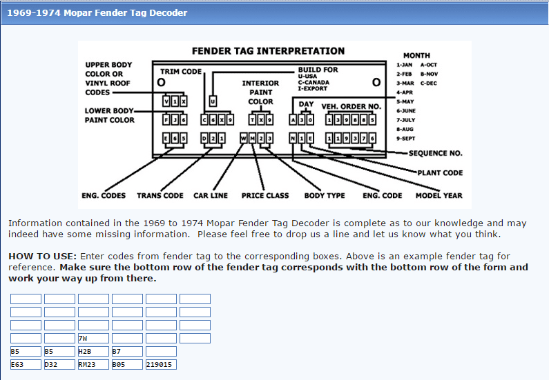

Pretty sure I've done this correct but I'm not 100% sure. use this site: http://www.mymopar.com/index.php?pid=87
RM23:
Plymouth Belvedere,Satellite
Medium, Road Runner
2 Door Hardtop
B05: 198 125HP 1-1BBL 6 CYL (LOOKS LIKE THIS # GOES IN A DIFFERENT BOX)
1970
Los Angeles, CA, USA
219015: Sequence number
E63: 383 cid 4 barrel V8 H.P. 335hp
D32: Heavy Duty Automatic Transmission
B5: Bright Blue Metallic Exterior Color
B5: Trim - Basic, Cloth/Vinyl Bucket Seats, Unknown Color
H2B: Unknown Int. Door Frames
B7: Build Date: November 7
: Order number
7W: Unknown
Lynch road tags don't tell you much.
Looks like a base hardtop 1969 road runner, 383 automatic in b5 blue with b7 blue interior. Without looking it up 7W could be a body side stripe maybe..
926 593 093. Are numbers to verify the motor, axle ratio and something else.
Google 1969 lynch road fender tags and you can find out the info.
Edit. I had a quick look
926 is 383 automatic Trans, heater 335 horse motor
593 is 3.23 Open rear end, 8 3/4, 11" drum brakes front and rear
093 is automatic transmission, 383 & 440 engines
B05 is build day, November 5
Rm23 is road runner hardtop
E63 383 335horse
D32 automatic transmission
Car is B5 blue sides and top
H2B is deluxe road runner interior in B7 blue
7W, I think is a side stripe but not 100% sure
Of course 9A163339 is your vin
All the other numbers on the top line are gate and plant info numbers
The numbers on the bottom right of the tag are order/production run numbers
So it is a Lynch Rd car ? Probably tick folks off...but if I get it, I'm gonna make an A12 clone out of it.
7W is a stripe code.
If it's a numbers match car you might want to clone a different one and restore this one as is? Everyone says there are lots of 383 road runners out there, but I don't see too many of them come up in project form.
Being a bench seat automatic no airgrabber or anything like that, it's a little lower on the demand list for sure.
Bottom line is its your car and you can do what you want!!! Good luck
