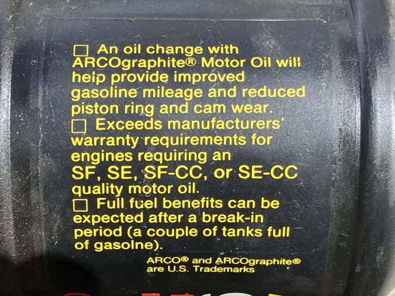

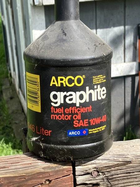

Thursday I got 6 quarts of this stuff:
I remember the TV ads for this stuff a long time ago.
SF is the highest rating when this was sold? They are up to SN or SO now.

I used that once in a 1980 Diplomat sometime in the early 80's. Turned the inside of the engine black. Subsequent oil changes became black immediately. Didn't hurt anything. Just had black oil forever after that.

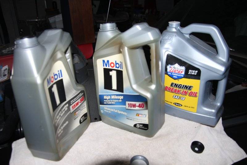

I have numerous factory sealed 5 qt containers of Mobil One that meet your above conditions, and now only have less than a quart remaining. A quart of what is IMO the biggest question, do I need to supply pics?
Here are three jugs, with lids removed to show factory seals still in place, with collpased containers.
