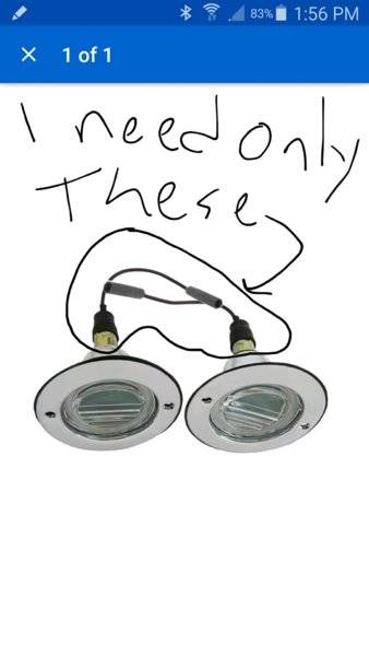

Hello, I'm hoping I can get some help or a point in the right direction.
I need the socket+wire only for the backup light bulbs. I can only find it as part of a kit that includes the entire lense and assembly.
Does anyone know where I can find just the wire and plug? I need 2.
If anyone could even tell me what these parts are called it would be a big help.
Aren't they part of the housing assembly or are they removable from the housing like tail Lights?
they call SOCKETS ;) &/or Sockets and pigtail
maybe some of these could help ? but maybe will require some trimming.
http://www.oemsurplus911.com/automotive/ligtsockets.htm
Or maybe you will need to change the internals ( available also there ), with the wire. HOWEVER you won't find exactly the same plug, just something that will work... bullet kind.
If you can't find the correct sockets and pig tails i have nice used original back-up lamp assemblies for a 70 Charger, PM me
