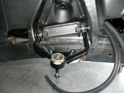

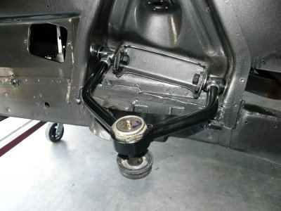

Not complaining about the fit or performance, pwder coat should not come off with a scotch brite pad period. Powder coating is a hard top coat once it's been baked, this crap came off like it was paint. I will say this, they did warranty the cracked bushing, sent me 4 new ones, so I have no complaints on that. The ball joint boots took a ****, the car has maybe a 1/4 mile on it, (pushed, not driven) whats with that? I'll eat the boots. Now here is a pic of what I did (after finding out it was not powder coated) to bolster the strength of the arms due to alot of having failures. Notice the gusset's, this will spread the load out over a greater area and not just concentrated on the 2 welds at the ball joint.
