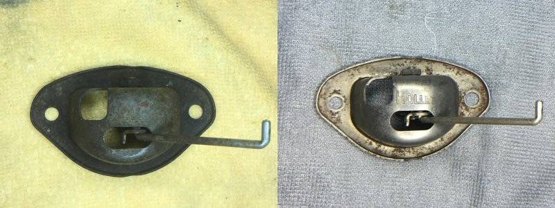

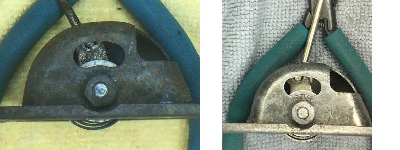

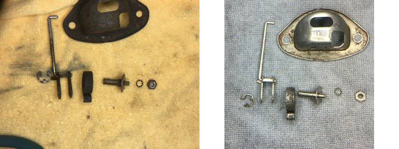

Rust removal, better than evaporust and 10x cheaper..
