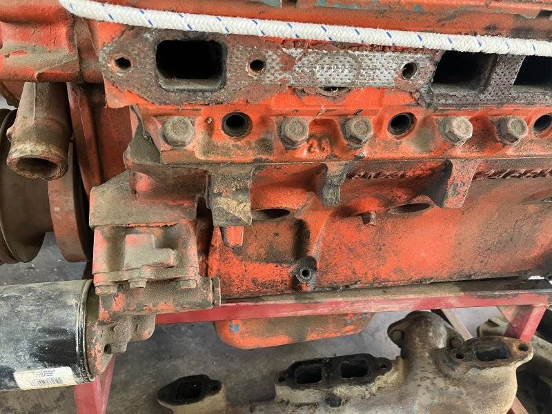

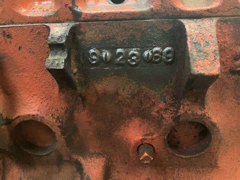

It's one of those 383 HEMI's we used to hear about.No kidding?

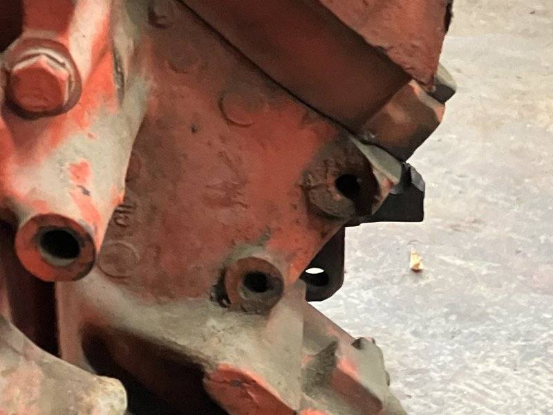

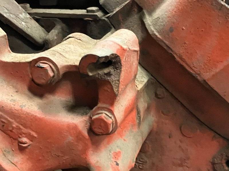

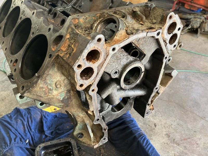

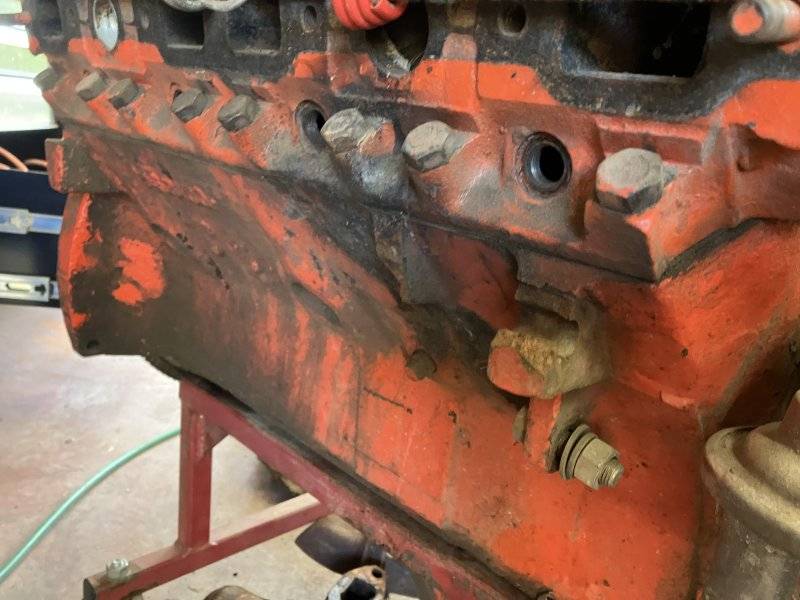

Maybe I’ll check with a welding shop to see what repairs like this would cost before I scrap the block.
If it can be saved for under a couple hundred it might be worth keeping.

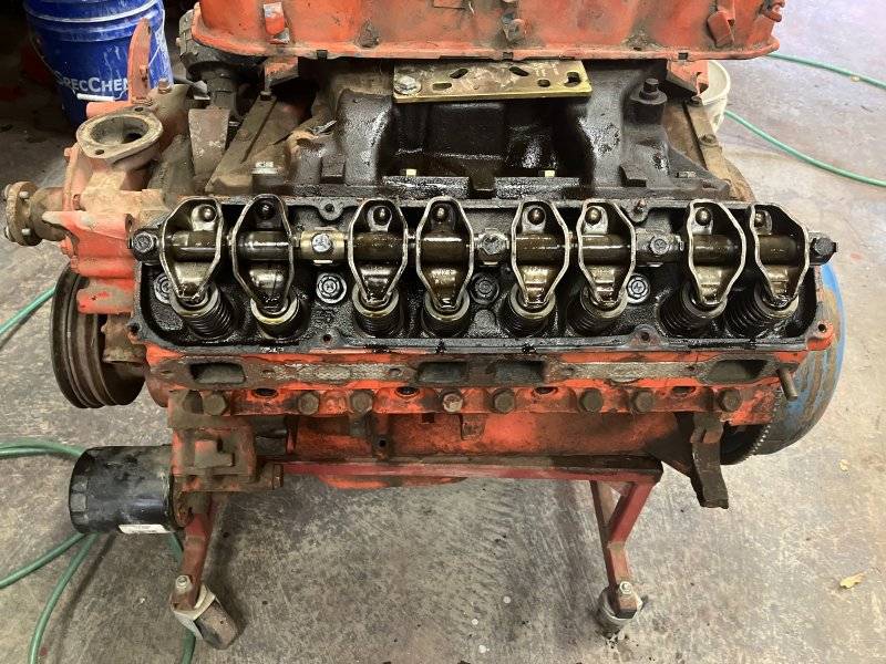

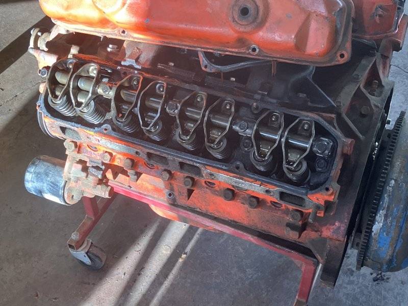

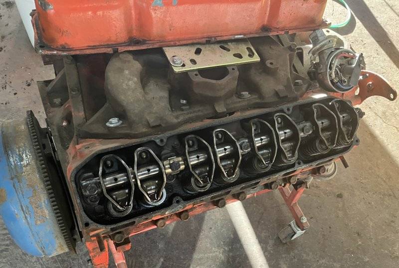

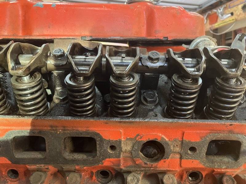

I removed the valve covers.
Right side 2468:

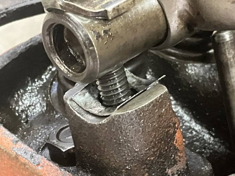

Hmm… what happened there?
The left side shaft is in correctly.

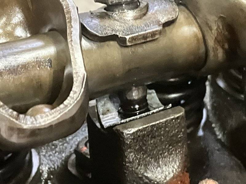

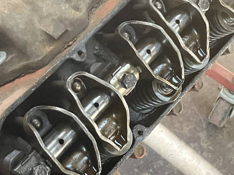

Here is a weird one:

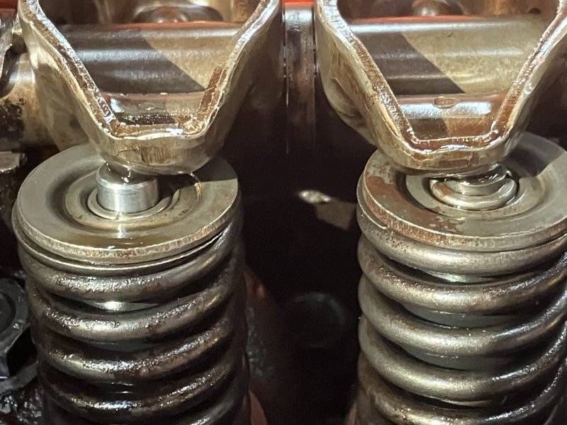

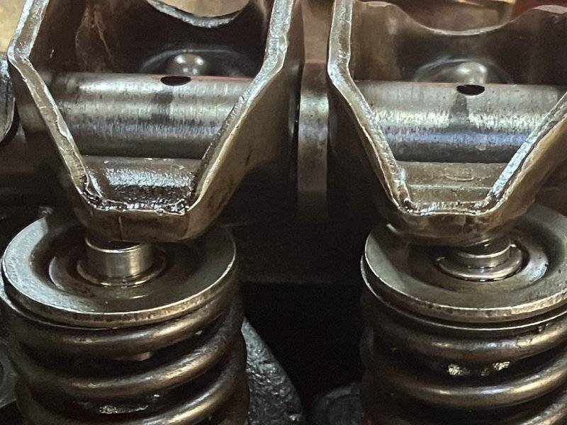

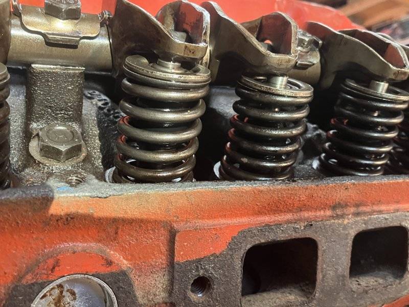

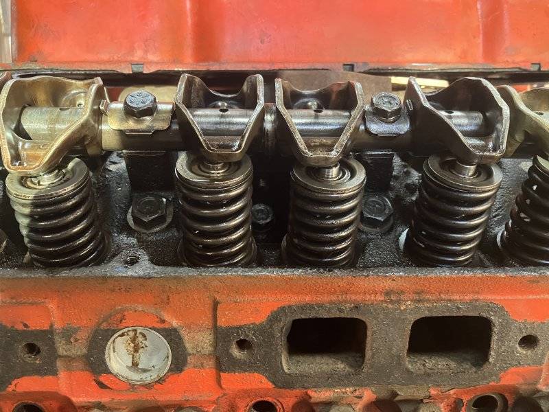

Look how far off center the rocker arm tips are over the valve stem ends.
Now check out how much the exhaust valve stems sit above the spring retainers compared to the intakes.
The retainers don’t look stock.
I’ve never seen rocker arms so far off the center of the valve stems.
It definitely is a 1970 engine.
