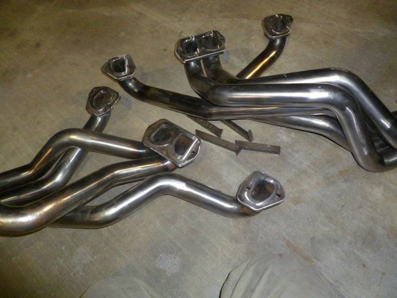

I like to cut most of the flange off and radius the sharp edges. Took off well over a lb on a pair of Dougs .
