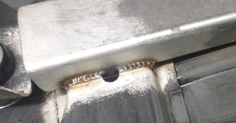

Nicely done. Did you stop the puddle or arc then move and arc again. (not really spot or stitch)
much easier on plate steel ....... I stop and start on sheet metal or eventually it burns through
I make sure its good and hot....... so it remains molten while I stop the arc...... then right back into it while it nice and red.....it also gives me a second to take a peek (through medium shade green glasses)
I call it stitching?

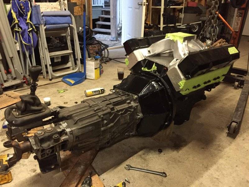

this might seem simple for a machine shop,but to build it with hand tools and the hobart is quite impressive to me! 512ci to zfs640 likely only one in the world!

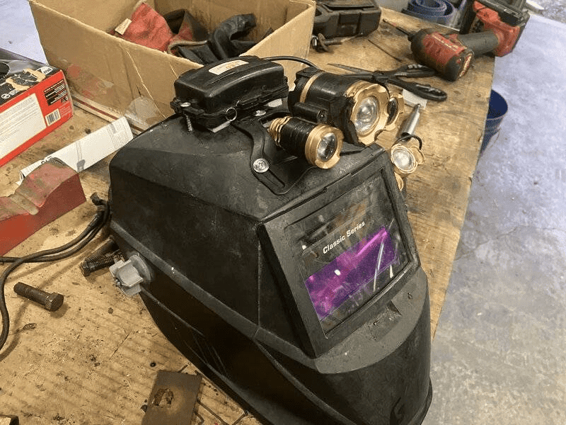

My helmet light was a hit in class today. The teacher said that I should buy a batch of them and offer to install them for $50 each!
It really did help out. I suggest that you consider it if you struggle in low light.
Those are weak....the light they produce is inadequate.
