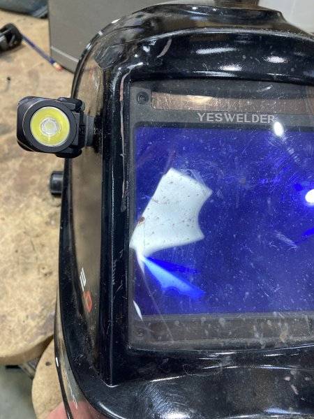

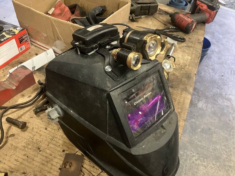

I’m getting older and my eyes are too. I attached a handgun light to my helmet. It works for me!

As we age, as our eyes age, first we need more light to see….then we need glasses, then thicker/stronger glasses.
I’ve found that even still with strong glasses, I often need more light than I did before. The booths at the college have a fluorescent lamp behind the work that barely lights up the stuff you’re working on. I struggled with the work today….
We all struggled with the stick welding but for me, welding blind sure made it a pisser. The younger guys didn’t have a problem with the lighting.

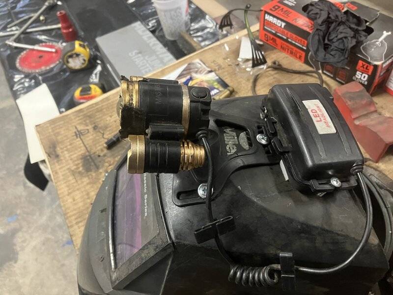

I stopped at the local welding supply to see about a welding hood mounted light. They had nothing. At home, I made this:
It is fairly simple. Back when I was still working in construction, we often started work before sunrise and needed light to see and work. We al started wearing those LED lights attached to an elastic band with power supplied by rechargeable batteries. I just cut the bands off and screwed it to the hood…
Once welding starts, the lens darkens for protection but before and after, a dim area makes it hard to know where to get started.
Tomorrow I'll give it a try and report back....wish me luck!

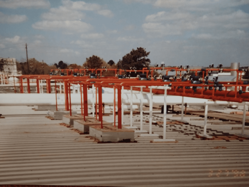

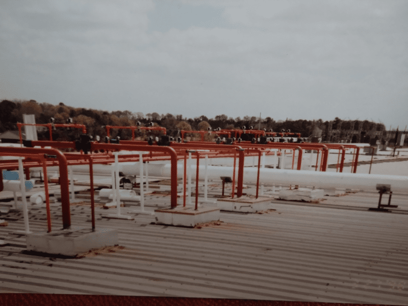

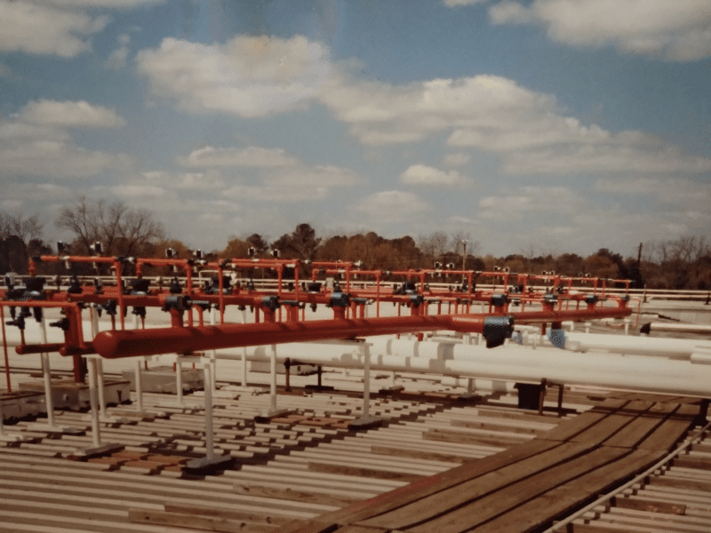

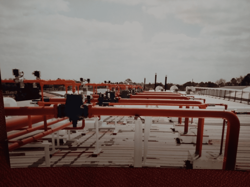

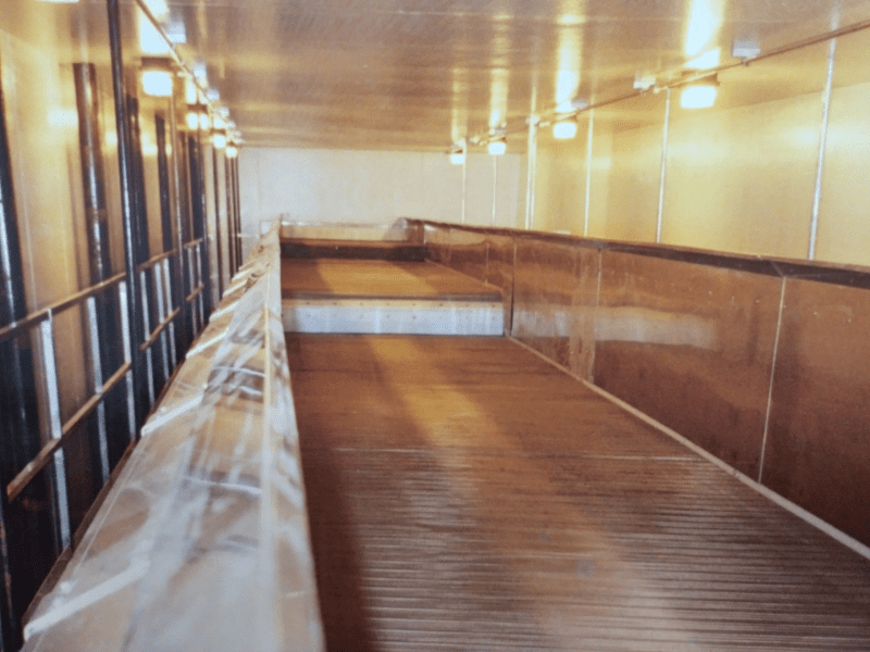

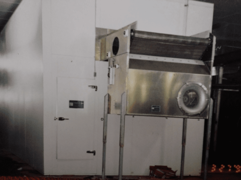

Here's a couple pics of an "I-Q-F"(Individual Quick Freeze) tunnel in Montezuma, GA that myself and two others built back in '98....when we got to the jobsite, we started with a bare concrete slab. Start to finish took five months......
This freezer box took washed and prepped produce from room temp to -47* F at the rate of 17,000 lbs per hour using anhydrous ammonia as the refrigerant, so you better make damn good and sure none of those welds leak!!!!!! All of these welds were "code" welds, 5P+ for the root and hot passes, and 7018 Lo-Hi for the caps, all done in-position-in-place.

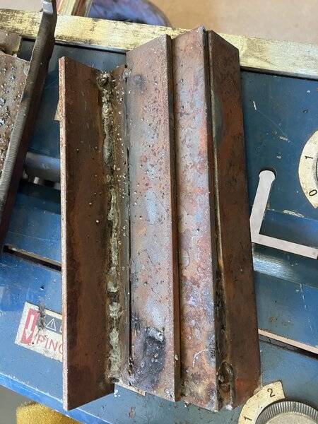

MIG is all that I have here at home. Sometime around the year 2000 I bought a Lincoln unit that first was a flux core only unit. I had some crappy welds with the flux core and was told that switching to the 75/25 Argon-C02 setup with a conversion kit. The switch made a huge difference in weld quality and appearance. I still struggle with overhead and horizontal work. The weld wants to drip out of the seam so I have to work more carefully. It is areas like these where I need the most improvement. Hopefully the class time will help me with that.
For overhead and horizintal work with a MIG, try turning your amps down just a tad and hold the nozzle a little closer to the work.....and don't stay in one spot too long, move steady and don't stop.
You can also experiment with different patterns of movement either side-to-side or back and forth. That can help to stop the dripping out of the puddle.
