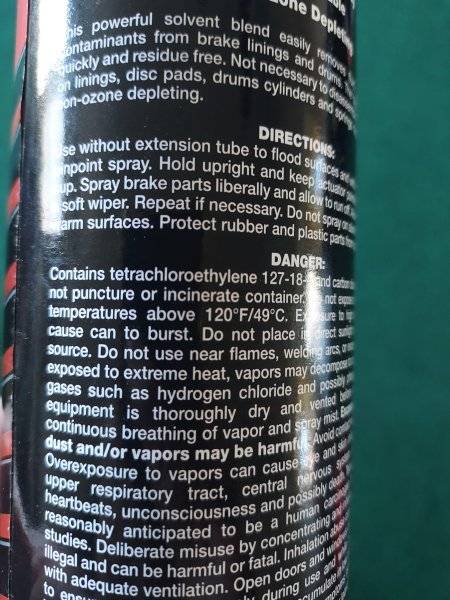

Another PSA for those welding who may not know. When using brake clean, or similar to de-slime what you're planning on welding, make sure it's evaporated off before pulling the trigger/striking the electrode etc. If you don't, it turns into Phosgene gas. AKA, nerve gas/agent. Very bad news.
My son is a welder, now I don't have to weld very often. He did buy a machine to do TIG, so I am trying to get a handle on that.
100% truth right there. I was welding on a garbage truck on an area that was 2 layers thick. I had cleaned up the area with brakleen. The area between the layers hadn’t dried and started putting out some terrible smelling fumes. I was in a very ventilated area, but had to get the welding smoke evacuator thing to finish. Terrible stuff.
Travis..
It's actually a chlorine (Tetrachloroethylene) that's in the cleaner. It will stay airborne for quite awhile. You may not even know it's there until you start burning. It's the reason they will evacuate a five mile radius when a chlorine train car derails and is on fire. Real bad stuff. You can buy parts cleaner without it.
Another hazard is welding some soft metals which contain high levels of lead, like some steel bushing material. If you start getting a headache and sore throat while welding, stop and evacuate the area and get yourself outside.
Which is most likely one of the reasons that the EPA has banned the use of Tetrachloroethylene in brake cleaner. The old brake clean with that chemical was non flammable, most newer formulations are flammable these days; I looked up the MSDS for one of the pails of brake cleaner at work and it was over 95% acetone.
Which itself would not be a good idea to have in a welding environment.

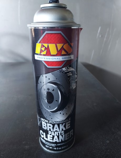

Checked my non flammable brake clean...

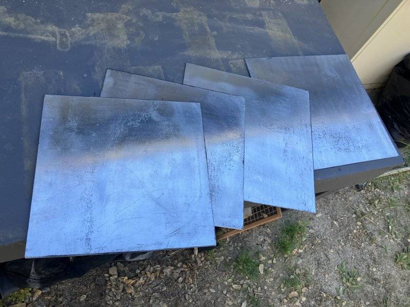

or welding zinc or galvanized coatings like they used on pipe, sheets
even some older cars metals
Like this stuff?
I made 4 turning plates for at home front end alignments and had a section left over. The nephew and I used a piece for the floorpan of this:
It didn't produce any weird vapors but did leave a weird chalky residue near the welds.
