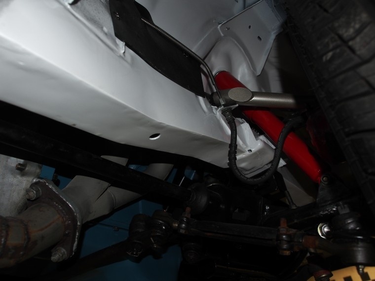

I had a rust hole in a frame rail on my '71
plated. The problem with that was the rust just comes back. I eventually bit the bullet and had the frame rail redone with an Auto Rust Technicians piece.
