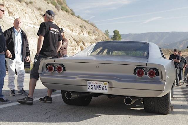

There was a 68 Charger that was used in the end of the 7th Fast and Furious movie. The car was named MAXIMUS.
It is an unpainted steel body where they dressed every bit of metal work with tools but no filler, primer or paint.
I’ll never be that skilled but it doesn’t hurt to try to improve my skills.
Here is that car.

It obviously has a clearcoat over the steel.

The rear of the car was widened. I don't recall how much but look at the shoulders of the quarter panels near the C pillars. Charger owners will notice that it is wider there on this car.

One thing that I do like about these custom Charger builds is the attention to the gaps around the bumpers. Note how tight the one above fits compared to a stock bumper.
