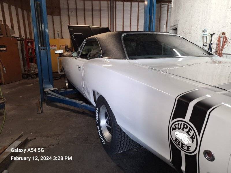

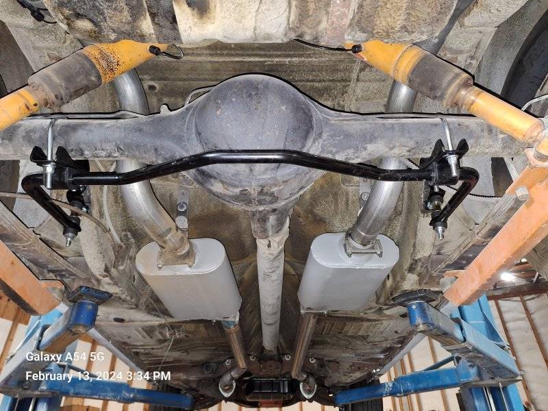

Build it the way you'll like it. I recently worried about the way my car handled. 68 Coronet 500 - 440 engine 727 trans - super bee tribute. Tires and big sway bars made a huge difference and did not break the bank. Tires are 15 inch, fronts are 225/60 and rears are 295/50. It had rear air shocks but now are stock. I suppose Q1 shocks all the way around would make a huge difference too. All of this without getting into the front or rear springs.
68 Super Bee.... NICE !

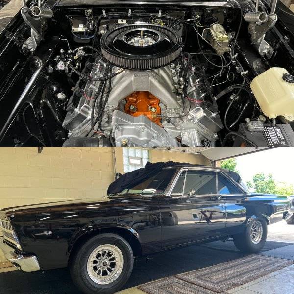

I’am really happy with my conversion, it’s not for everyone and I get sneers from people when they see it but I don’t care. Car has great power and is fun to drive again.
