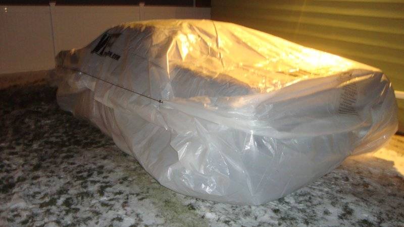

Anyone using one? Both of my insulated metal barn/garages are dirt floors, so not exactly climate controlled. Humidity is always high. Right now in winter it’s over 50%. Anyone have experience using them?

No worries. According to the bubble website description, the ventilation does move the humid air around, but it’s the condensation from the humidity that condenses on and in the car that is the problem. The ventilation keeps condensation from forming and the bubble keeps dirt and dust off the car. I’m wondering if anyone here is using one and what are their thoughts on it? They make both indoor and outdoor bubbles. The outdoor ones are little more sturdy for snow and rain. Both indoor and outdoor models use the same mil thickness floors, so I assume the indoor model would work fine with my dirt floors.

I like the one @RR Fan Dan posted above. 9 bills is pretty steep for the outdoor one I would have purchased for the Newport if I had known about it, but you could probably reuse it at some point.

I have one in the garage and it does collect moisture but not enough. Car still sweats. An industrial one would cost 3 times as much as the bubble. So I thought I would try the bubble.
I may just be showing my ignorance here. If the car bubble uses a fan to keep the air moving around the car, why not just move the same air throughout the entire building with strategically placed fans? Put some wood pads down and jackstands on top of them. Car on the jack stands. Car cover, small fan under car.
It’s a big garage. Plus there are other benefits to the bubble, such as the filtered ventilation to keep car clean( no dust), and it keeps mice out.
