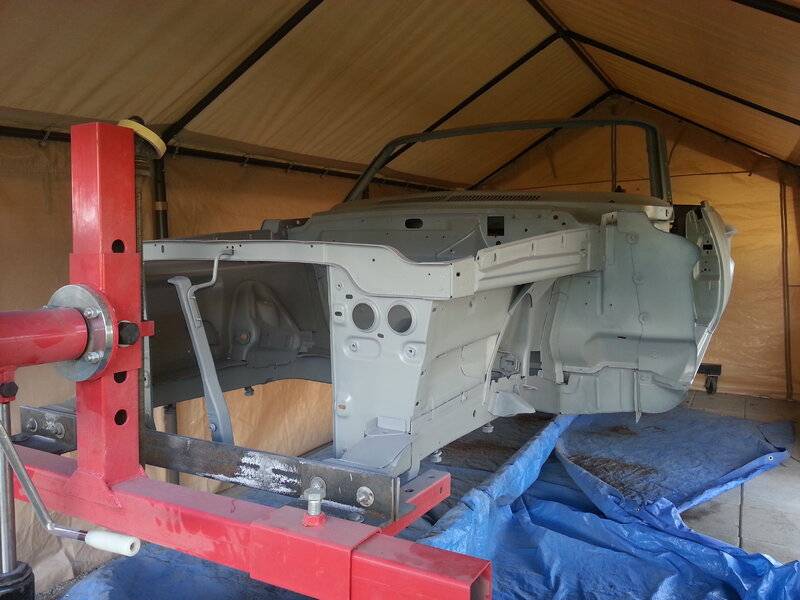

I didnt have any extra support but i didnt have to repair any panels. I tried putting the doors on but the jambs were to tight but as soon as i got it back on 4 wheels everything was fine. I later welded in frame connectors to stiffen everything up. My door have a perfect gapView attachment 961700

When i first brought i down from Chicago I could not put it in my garage. I bought a cover from Costco. We put an air line out to it and electric. It actually worked out after blasting i was able to rotate to clean the phosphoric acid off real well and i epoxyed it and painted the under carriage, engine compartment, trunk, and interior, everything except the outer panels Then once we mounted the suspension and 4 wheel disc brakes we rolled it into the garage. Yes i did all my welding on my back but it was the only way i could guarantee my door gaps were going to be correct. 35 years ago i went to school for auto body. I have to tell you the paint goes on much easier than the paint did in the 80s. This was truly
shade tree painting and it came out perfect. The rotisserie would not have rotated in my garage. This was the day we moved into the garage.
When i first brought i down from Chicago I could not put it in my garage. I bought a cover from Costco. We put an air line out to it and electric. It actually worked out after blasting i was able to rotate to clean the phosphoric acid off real well and i epoxyed it and painted the under carriage, engine compartment, trunk, and interior, everything except the outer panels Then once we mounted the suspension and 4 wheel disc brakes we rolled it into the garage. Yes i did all my welding on my back but it was the only way i could guarantee my door gaps were going to be correct. 35 years ago i went to school for auto body. I have to tell you the paint goes on much easier than the paint did in the 80s. This was trulyView attachment 965926 shade tree painting and it came out perfect. The rotisserie would not have rotated in my garage. This was the day we moved into the garage.

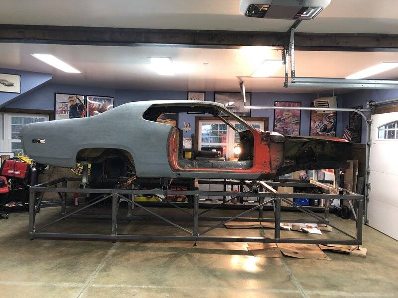

I would also suggest building a frame jig. I did. I also have an Accessible Systems rotisserie. I could not image removing and replacing as many parts as i have so far on my rotisserie. Having the body only supported at the front and back will only lead to a lot of flex. Comparing my jig and the rotisserie, I’m thinking many of the pieces from the jig could be used to build a rotisserie. You could save some money that way. I’ve seen people build rotisserie’s out of engine block stands.

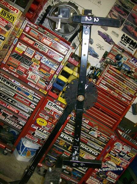

I have built 2 of my own Rotisserie's now at a couple of hundred bucks each. I got tired of showing everyone who borrow's it how to assemble it. So I numbered all the pieces at the mounting points. It has had everything from a Challenger, to 2 Chevelles and C10 cab and bed mounted to it. My Road Runner is next.
