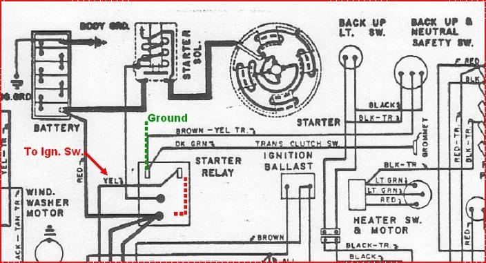

The starter relay is a nice easy way to begin. First, you've proved the car will start if you short the starter relay main posts. Now to check if the starter relay is activating.
1. With the car in Park, remove the yellow spade connector from the starter relay. Short the large 12V terminal to the spade lug of the terminal you just removed. If it cranks, your going to have to look inward toward the starter switch/key mechanism and like Lionized suggested, bulkhead terminals are always suspect.
2. If it doesn't turn over, you now need to check for ground on the other terminal (from the neutral safety switch). Remove the connector (Brown/yellow tracer). Use a jumper wire and connect the empty spade lug to a good known ground. Repeat step #1. If it doesn't turn over, it's the neutral safety switch or the harness for the NSS. Since they just worked on the transmission, I'd be suspect about that. Make sure the NSS harness is correctly plugged into the transmission.

I grounded the NSS stud on the relay.... Car fired right up
Will have to check the canon plug on the NSS
Is it possible the plug is on backwards?

The plug only fits one way. It's possible the shop broke a pin attempting to re-install the plug. You could pop it off and check.
