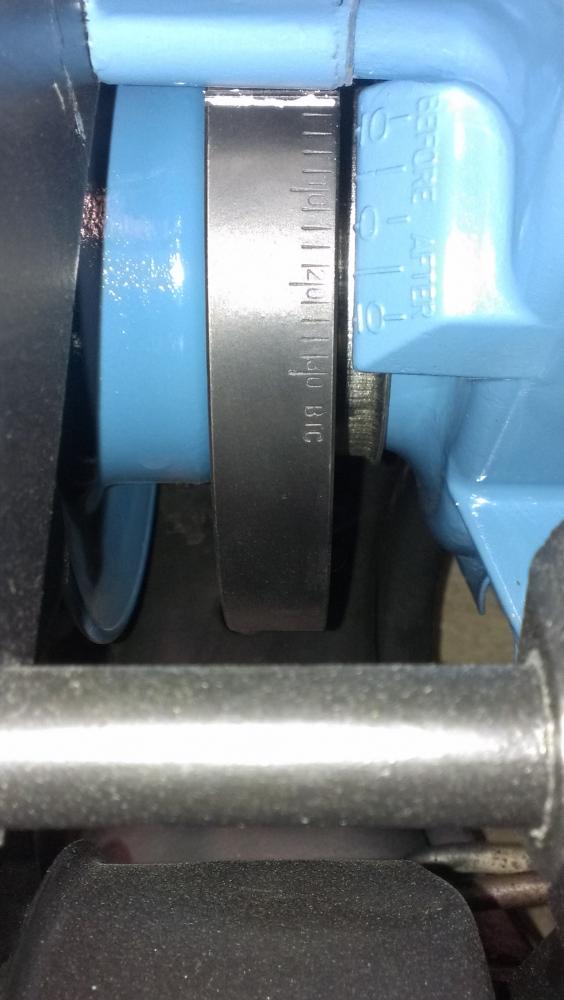

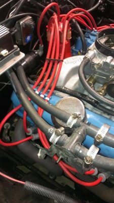

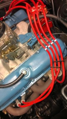

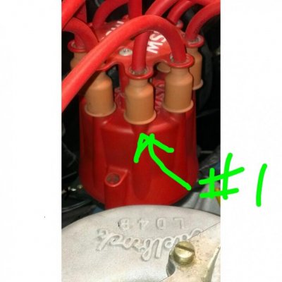

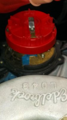

So here is where I stand. I just wanted to verify with all you my steps before I startit up again.
This is where my timing is set (14* btdc compression stroke)
Rotor pointing at number one wire
Order of my wires

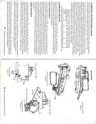

So I got my hands on another timing light and confirmed mine was damaged. I ended up setting timing to 35* advanced at 2500 rpm. I am almost at where I want to be to be able to drive this thing. Only issue I am having now involves the choke. I noticed when I let it open, idle increases. When I hold it closed with a small amount of opening, it idles just where I want it to at around 850 Rpms. I feel like my choke is misadjusted, although I did set it via edelbrock specs. ( by the way the carb is an edelbrock 4 barrel #1406 with an electric choke). My question is how does the choke operate? Does it have to open after warming up? Can I just tighten the choke valve to where it keeps the choke plate closed?

All the choke does, is exactly as it's named. It 'chokes' the air supply to the carb, forcing an overly rich mixture. You do not want that rich mixture all the time. It would effectively 'wash' oil off your cylinder walls, and piston rings, and flat wear them out.
It's been way to long since I've messed with an electric choke. Can't recall exactly how they work. Somebody else jump in here.
Off the top of my head, the choke adjuster should be backed off, until the choke plate is fully OPEN. Then, you turn it back in, until you have a measured gap at the top edge of the choke plate. That gap you'll need to look up.
Last...you do not want to adjust any timing, or carb settings, until the engine is at least warmed up...choke fully open!

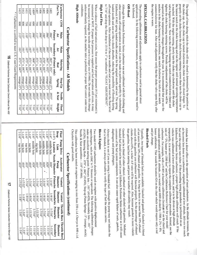

The electric choke operates with a bi-metallic coil, that is, a spring under the cap that is wound of two dissimilar metals. It uses 12 volts to heat the spring and 'unwind' the choke blade at a given rate. There are 2 contacts on the plastic choke cap. One contact gets grounded (one of the cap hold-down screws will work) and the other gets an ignition operated 12 volts (can take off the ignition side of the ballast resistor). When the motor is stone cold you adjust the blade by loosening the 3 plastic cap hold-down screws, opening the throttle a bit (to release the fast idle cam), and turning the cap CW while watching the choke blade close. When the blade is just closed, tighten down the 3 screws.
This will get the adjustment close. The fine tuning of the choke including the setting for the blade opening and the fast idle will are below, which is from the Edelbrock Owner's Manual.
Everything else in your timing and plug wire pictures looks perfect.
Good luck...

A key point here is that the engine should be tuned with the engine fully warmed up and choke wide open. Then you can worry about the high idle choke setting.
Absolutely. So, to set the choke blade wide open, disconnect the hot lead, use tape to insulate it from ground and loosen the 3 cap screws. Then slightly open the throttle and turn the cap CCW until the choke blade is open with a little spring pressure to keep it there. Then tighten the 3 screws.
This assumes that your car will start without a choke....if not, see my original post.
