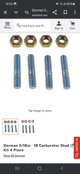

Figured with this it's so old most parts stores wouldn't be able to tell me if it's the correct fit or not. I know they have studs, I just don't know what size to kit and would trust someone's opinion on here alot more than a parts store computer

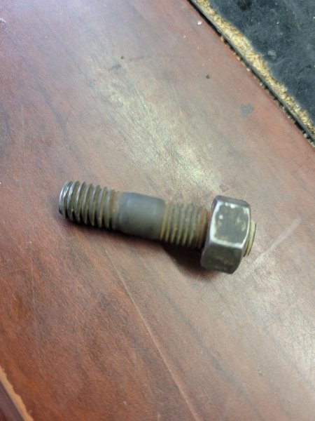

Looks like right at 1 3/8". 5/16 fine/ coarse.

Course thread goes in to the manifold. Fine thread gets the nut. Size and pic above. Post number 5. Some stores are vacating the nuts and bolt business, but you should be able to find a store that does have them. Snug and tight with a 1/2 spanner. I am not home so can not check to be exact.
