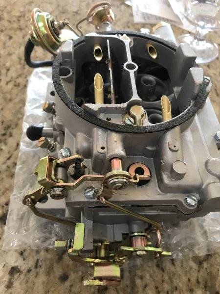

You could look for some 575 rods as they are only different at the WOT step being .053. A 216 rod is same as factory except the cruise step is a bit leaner.
