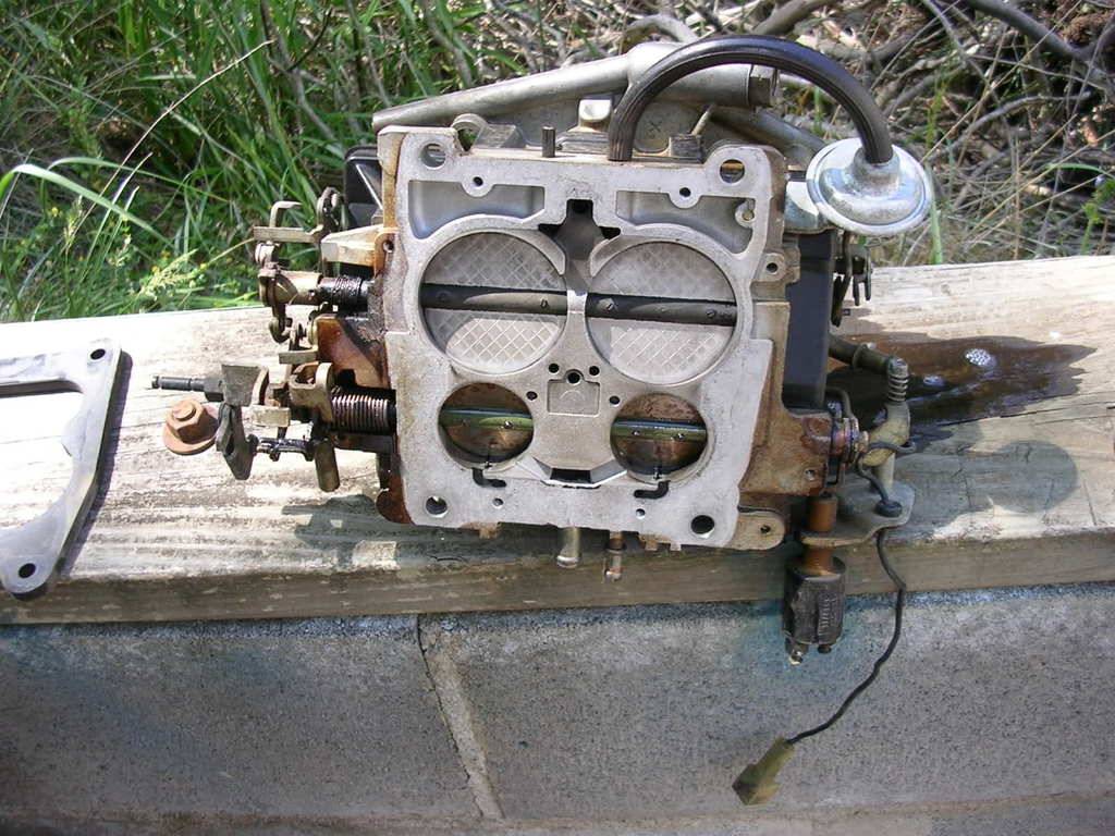

The bolt holes that hold the carb on the manifold will most likely match up so mounting it won't be a problem. If you are referring the barrels of the carb, they too should mate up nicely. I am assuming you are using a square bore type carburetor currently and your manifold is a square bore as well. By square bore, I mean all four barrels are the same diameter as opposed to a spread bore (i.e. Quadrajet commonly found on GM vehicles).
This is a spread bore carb bottom:

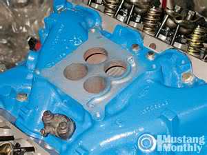

This is what a squarebore manifold looks like:
Does your manifold look like this one?
