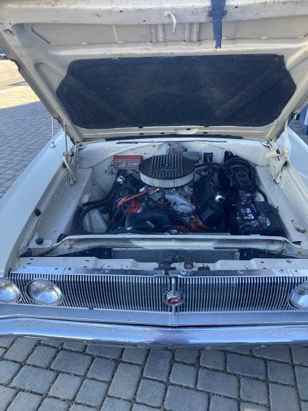

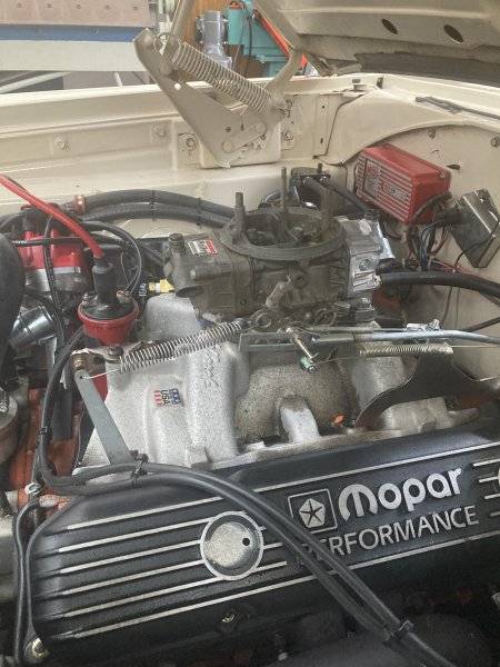

I have a 67 wagon w/440. Performer RPM with a Holley 3310-1[ 780 vac sec] carb. Filter assembly is a MP one. Fits under the hood with no issues. This filter unit won't work with an AVS/AFB unless you put a spacer between which will get you hood clearance issues. The base only works for center hung bowl Holley's due to its contour. There are low profile units that will fit the AFB/AVS and some others. You'll need to check around. The inner portion of the base, where it drops over the carb, looks like it was formed over a big bagel/doughnut. Big, dropped circle.
