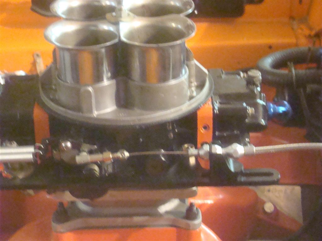

Did someone say 1050 dominator? hehe. Pain in the a&& to tune a 3 circuit for the street but when you stomp it it opens the gates of hell.
