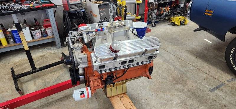

I spec'd and built the 505 myself. The only work I farmed out was the machine work. I've built several engines in my lifetime. I've owned "The Beast" for over 40 years and she's gone through 4 different engines and transmissions during that time, all built by me.
Granted, this was the highest HP and I had to do TONS of research but I had spend 3 or 4 years building it in my head reading article after article and honestly, I thought I had it figured out.
Maybe I didn't, maybe I did. The truth will be revealed on the dyno ( I hope).

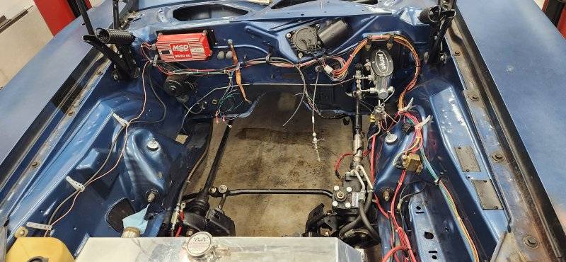

Anyway, with the help of a couple friends and a couple hours, the engine is out
