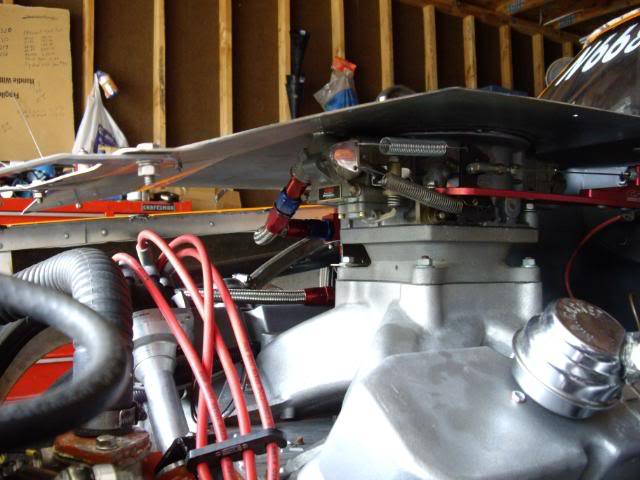

The original engine in the race car was built by Muscle Motors.<br>They had complete control over the build.<br>What I told them was I wanted a 9.70's engine based on a 400 block.<br>The intake they used was the Indy 4150 style with the spacer going to a 4500 carb.<br>They said this would speed up the air and give a better air fuel distribution.<br>With this conbo the car went a best of 9.599.<br>This was with a non roller cam.<br><br>
645 hp to the rear wheels.

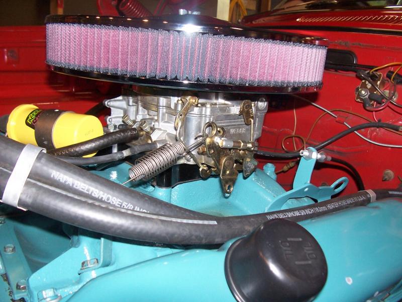

View attachment 003.jpgI have a carburetor insulator plate..IT works, and seems like more power?...a bit?
the 63 starts e-z 'er..the gas( if you want to call this reform' crap gas,) does not boil after driving.

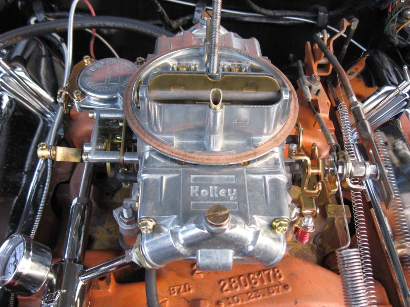

when i changed from the edelbrock carb to the holley, i needed a one inch spacer for clearance reasons only. its a wood one...(pressed wood i think). im not sure if it was the carb or the spacer...but the throttle is alot more responsive....BUT...i have just enuff room to close the hood. i wasnt really after more horse power,,,just wanted that eddy off of there....but it does run better and starts alot easier for some reason .! the new Holley 850 sits on a stock 1967 440 intake manifold
