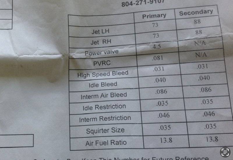

Hi All,
Just purchased a Proform 1050 cfm carb for my 496" (383 stroker) and I am curious if anyone has this carb on a similar engine as described below and if so where have you ended up with your jet sizes?
This engine is in my '69 Coronet resto-mod street cruiser. I doubt seriously it will ever see a race track.
The carb was shipped with 87.5 primary and 91 secondary and a 4.5 PV in primary, none in secondary.
440 Source stroker kit
10.5 comp
Stealth CNC ported heads
Mopar M1 intake
Howards roller 565/565, 241/247 @ .050, 110 LSA
HS 1.5 rockers
MSD ignition
Hooker long tubes (1-3/4")
3,000 stall converter
3:55 gear
If this was a pair of 1050 Dominators on a 468" BBC I could tell you just what you need to be in the ballpark but I don't have much experience with the single carb setups.
I know how to tune it, I am just asking if it's close in its as-shipped state.
Thanks for your input.
Mike
Just my 2 cents but 87's in the primary's seem a little big for street car, I'd stick 72 or 74's in the front and 84 or 86's in the back. The way the carb was shipped is more of a extreme street strip setup. Obviously reading the plugs or air-fuel meter will get you dialed in.
What size are the HS air bleeds?
Does it have downleg or annular boosters?
I’d suspect it’ll be happier on the street with less primary jet, provided the air bleeds aren’t too big.
I’d also lean towards a higher rating PV to go along with the smaller jets.
Air bleeds are 31's and are changeable, boosters are down-leg.
Agree on PV.
PVCR jets are also changeable. I haven't measured them yet so not sure what they have in there.
Thanks
Mike
Most of the common 4150 “1050’s” have a 1.59” venturi.
If that’s what you have, with downleg boosters they generally use pretty big jets, but admittedly I’ve never run one on a combo as mild as yours.
I’d leave the secondaries alone for starters, and would try 84-85’s in the front with a 6.5pv.
Ultimately you may end up wanting to install an O2 gauge in the car to see what’s really going on.
It might be challenging to find the balance between the correct a/f ratios for part throttle cruise and wot.

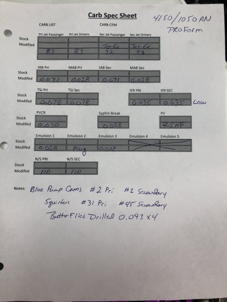

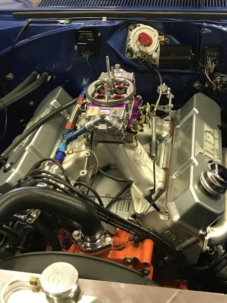

I run a 1050 AED Dominator on my 505. I’ve made adjustments on it but I have the spec sheet from new. For reference if nothing else.
I’d have to look at my build sheet but I believe I had an 84p 92s with a 1.59 Venturi annular booster carb. .028 hsb. Pvcr was in the .070 range. Keep in mind most of these carbs have a fat cruise due to the transfer slot and not the main jets. Usually takes transfer slot restrictors to really dial them in perfect. 02 meter sure helps.
Found the build sheet I made after I tuned it. I spent a lot of time on this one as it was one of my first custom builds. Great carb, drive it daily and go rip off some high 10’s..
