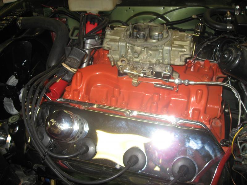

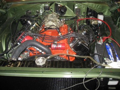

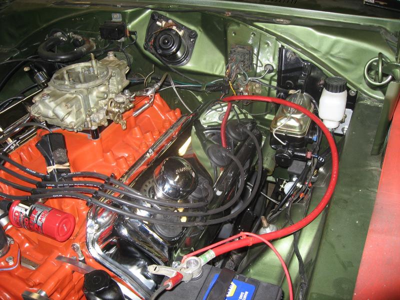

X2--i am running a single 850 holley on my hemi and really like it. as long as it keeps operating as well as it is i won't consider putting the 2x4 set up on.
.02 cents:headbang:

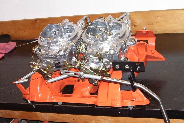

I have the Edelbrock Dual Quad intake with Performer Series 600 CFM Carbs.

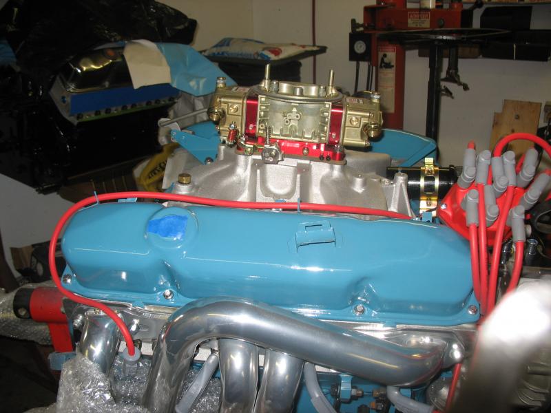

Holley Street Dominator and 950 Quickfuel

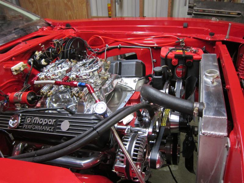

Thanks guys, nice pics, "440Runner" thats hot, hows it run? 6 pack setup is nice but very expensive, and it looks like a headache, i think i am going to go the dual quad edelbrock intake not sure to go 500 or 600's ive eard that eddy's 600's are a bit rich for this might try jetting the 500's if they dont have enough grunt???

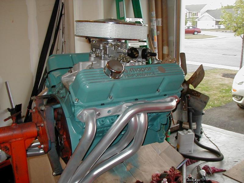

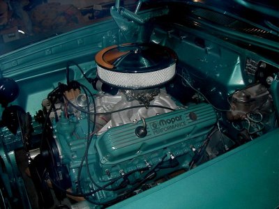

Holly Street Dominator with a Carter 750 Competition Carb., yes..its a 383
