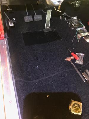

Hey guys. Getting ready to trim my carpet.. The rear carpet now has the proper cut outs.
Still need to do the front.
Two questions:
1. How far forward up the firewall should the front half go? Or where should the driver heel pad line up with respect to the brake pedal?
2. Where is the correct place to trim the sides? Do the sill plates clamp the carpet? Should I trim to the outside edge of the sill plate?
Thanks MF

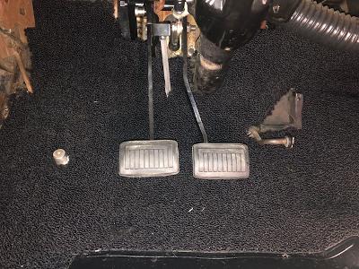

Get pics of where everyone locates their gas pedal on the heal pad. Also the end normally meets where the firewall insulation ends.

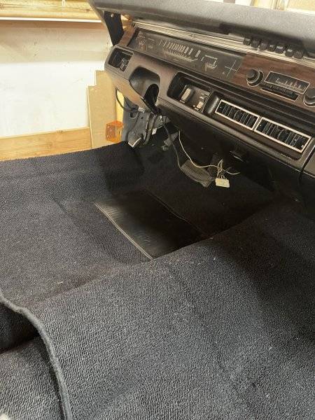

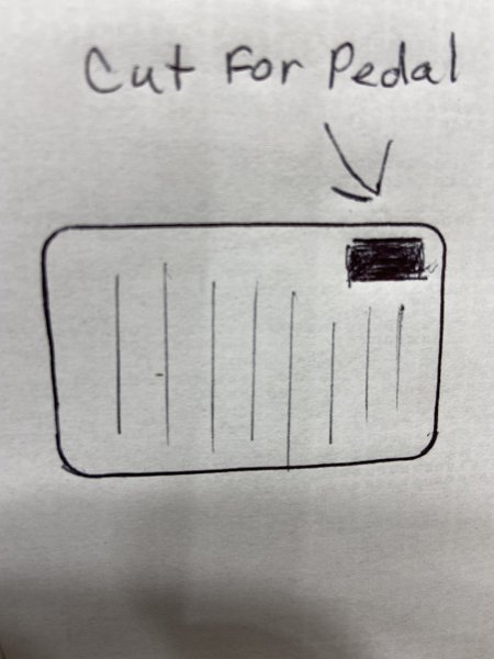

This is a picture of mine I done a couple of weeks ago. I cut the heel pad in the top right corner to fit the gas pedal bottom part first. Then put the gas pedal in the cut out and slid it in place so the gas pedal dropped in place. Then put the nuts on the pedal from underneath. And it was in the right spot forward And sideways. I hope this makes sense.
You want the entire bottom of the pedal on the heel pad.

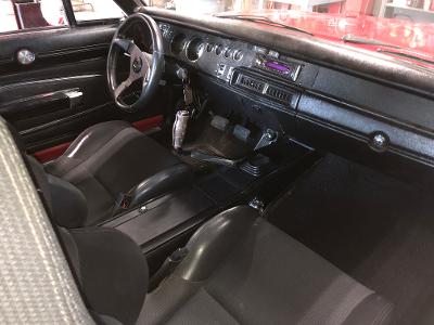

My carpet (Bought in late 2020) ran up above the steering column.
