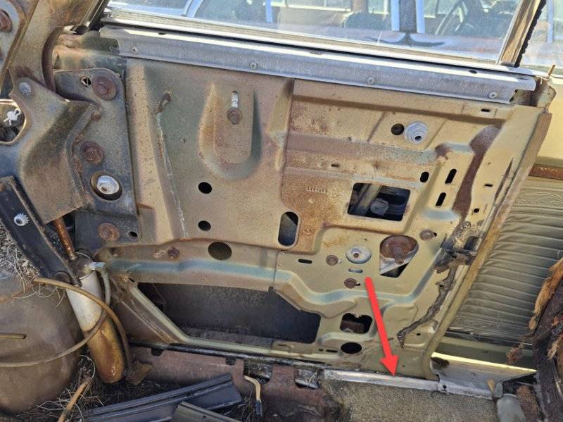

Im looking at some junk yard cars here and looks like I am missing these trim pieces that go in the back seat floor area. Does anyone know if these are visible once the interior is together? Does the seat cover this area? Is this to just to help hold down the carpet? Let me know...I think this was used on multiple years.
Working on a 67 convertible and photos here show a 66 Satellite and a 67 Coronet.
Ok so without that will have issues with the carpet edge. I dont think they make a reproduction of these? It looks like a flat piece of stainless basically. And this is not "convertible only"?
It's not just a flat pieces of metal. I can't find a suitable picture to show, but it would be obvious to someone looking in that area. I see them available from time to time. Start a WTB ad.

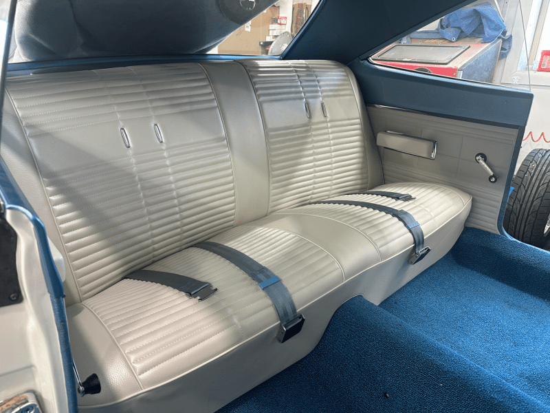

Thought I had a pic with them installed but couldn't find it. Here is one before I installed them. They cover the span right under the window crank between the seat and door edge trim.
The bitch of it is getting the screw lined up and in, between the seat and quarter panel trim.
Ok great....those photos show alot. I think it would look goofy without those installed. Really makes the black interior pop with that in there. Nice.
