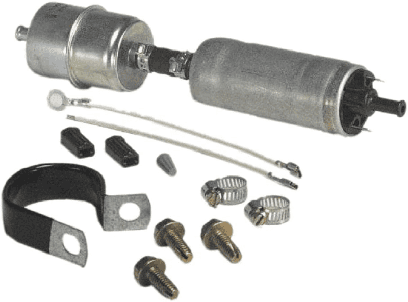

This:
Carter Fuel Systems In-Tank Universal Electric Fuel Pump Automotive Replacement 12V (P60430)​
Available in either 5/16" or 3/8" fittings. I install these along with a toggle or momentary switch under the dash on all my cars with a carburetor. The problem is today's gasolines have a lower Reid Vapor Pressure number because they are formulated with more aromatics and lighter base stocks to increase volatility making them vaporize more quickly which modern fuel injection systems require. The problem is when you switch the engine off the fuel in the bowls of a hot carburetor begin to boil off and if the car is not started again in a few days there is no fuel remaining in the carburetor for a restart so you will have a long cranking time getting fuel back up to the carburetor. The answer is switch your in-line fuel pump on for a few seconds to refill the carburetor for a quick restart.
This: Amazon product ASIN B000BZX920
Available in either 5/16" or 3/8" fittings. I install these along with a toggle or momentary switch under the dash on all my cars with a carburetor. The problem is today's gasolines have a lower Reid Vapor Pressure number because they are formulated with more aromatics and lighter base stocks to increase volatility making them vaporize more quickly which modern fuel injection systems require. The problem is when you switch the engine off the fuel in the bowls of a hot carburetor begin to boil off and if the car is not started again in a few days there is no fuel remaining in the carburetor for a restart. The answer is switch your
