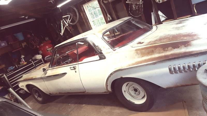

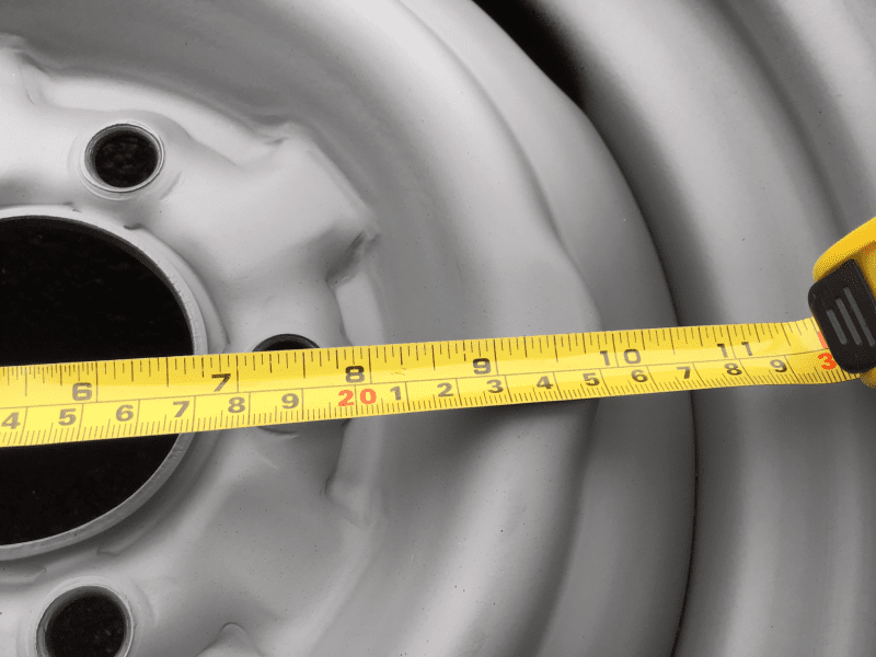

Yes you need to measure your wheels where the caps go. Do you have 10" or 9"? Then you can go shopping for caps. See photo. The dodge caps in your photo are 10"
1967 B body was 10" caps the entire year. I had a car with 7/5/1967 build date with body color wheels and 10" caps.
I’ll measure them tm. I did get a picture of the numbers on the inside of the rim when I had new tires installed, but I found nothing searching.
The dog dish with thin trim rings, letters in unless they say Goodyear or Firestone. No Cap, chrome lug nuts and trim rings looks good too. I went with the dog dish and trim rings

I didn't notice the back wheels were not cop wheels. You will have to swap two of your wheels so the hub cap diameter is the same on all four, if you want the caps to match.

15x8s that take a10" cap were probably custom made. As said above, cop rims take the small 9" caps. See if you can find some ramcharger 15x8 steelies, they take the nine inch caps too.
I've got a 62 with 15x6 on the front and 15x8 ramchargers on the rear, with 67 barracuda caps, (cause that's what I could find in the garage. Got some dodge red ring caps too, but I couldn't find them.....)
I forgot to mention, I've got an A12, so I'm stuck with the naked black wheel look. I didn't care, I ran dodge red stripes on my Plymouth anyway. I do NOT care for the naked steelie look.

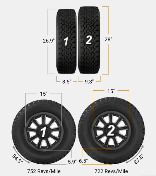

What are the offsets and tire sizes on that 62?
The 15x6 are A12 rims, 4" backspace I think, with 235 70x15s. The rears are 15x8 ramchargers with 4" bs also, not enough offset for my car to run 275s, so there got 255/70x15s on em. I've got some 10x28x16 slicks that fit great with 4 3/4" bs. (very dusty Arizona garage).
235 is bigger than I thought would fit a 62 front.

M/T L60-15 15x8 4.25 backspace
Cooper 275/60/15 15x8 4.5 backspace
215 vs 235

The fronts on the tt's are actually 235/75x15s! (On 15x7, 29+ tall) The ONLY way they fit is cause some previous owner relieved the heck out of the splash panel at the front of the wheelwell. They DO rub at close to full lock on the header tube thru the inner fender panel.

I've never seen a 15x8 wheel that takes 10" 66/67 caps.
Another option- paint 1/2 of your rear steelies "body color".
'68 caps look somewhat similar and are 9".
