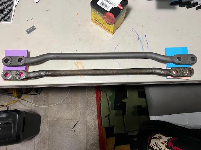

The dropped link is obviously longer than the stocker, in their own picture. In the description they say they are identical to stock except for the drop. Go figure.

As a note, the two links below are the new 440 source and Mancini distributed dropped link and my own lightweight link made with Chromoly 1"OD X 120 wall tubing. Never a problem for the last 15 years or so. Then again, there isn't much of any bends in it for the most part. Never thought that it needed any kind of heat treating.
Take note of the difference in lengths below. Stock OEM specs they claim? I don't think so. mine is to the hair as far as stock measurements.
Take note of the difference in lengths. Stock OEM specs they claim? I don't think so.

That length difference is puzzling.
Probably should have asked previously, what are the diameters of the solid links pictured.
I'm out of town at the moment, but will take measurements as soon as I return on Wednesday.
Yes, the difference is almost a whole inch from center hole to center hole.
