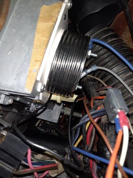

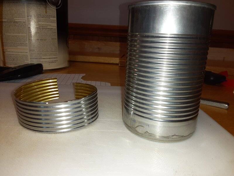

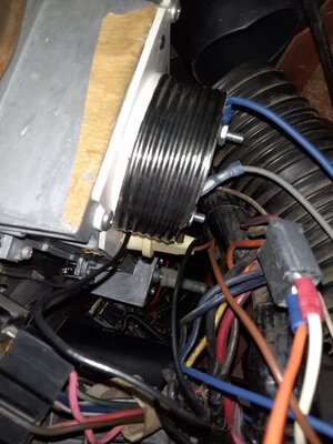

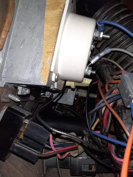

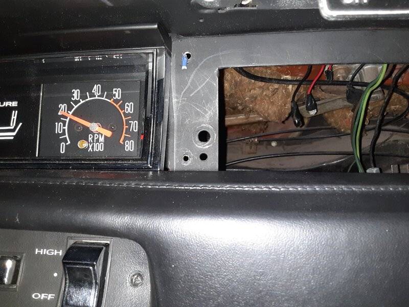

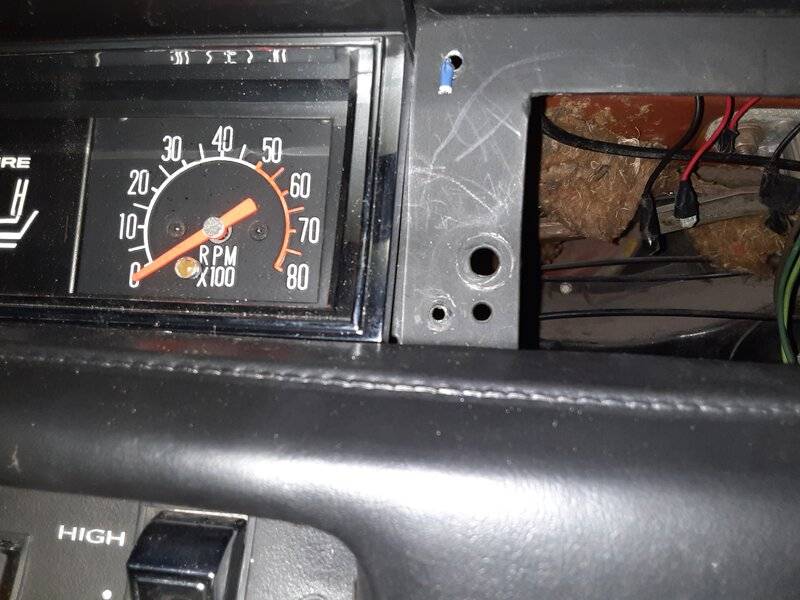

I fixed it for $0. Aftermarket dash tach has no shielding. It's in a plastic case. My Big *** JBL speakers are center mounted under the dash. Tach read 2000 RPM with battery disconnected because of magnetic interference from the speakers. I cut up a soup can (must be ferrous metal i.e. attracted to a magnet. Lead, aluminum, etc. won't work) with a Dremel to get a 1" wide curved strip of metal. Slit it to clear the wires of the tach and secured it to the barrel of the tach with two sided tape. Before and after pictures below.
20211105_154909.jpg 20211105_155058.jpg 20211105_155205.jpg 20211105_154745.jpg 20211105_154849.jpg
2 JBL 4" mounted side by side on a piece of 1/4" plexiglass. Radio is from '69 Plymouth with updated guts. 40 Watts. All speakers were rescued from an Infinity in the scrapyard.
