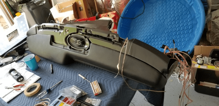

Loosen the two under the kick panels. Pull the studs for the steering column, remove the 4 across the top. Now you pivot the dash forward to access the rear to disconnect wiring, speedo cable, etc. before pulling the entire dash out.
So I can't take my speaker grill cover off because the dash cap is blocking it, and I can't take my dash off because of the speed nuts. What a mess!
Finally got the dash pad off. I would have been screwed if either of the end speed nuts didn't want to come off. Luckily they were little trouble.

Since I have the steering column out, instrument cluster out, and most everything else out, I might as well remove the dash and treat all the surface rust.

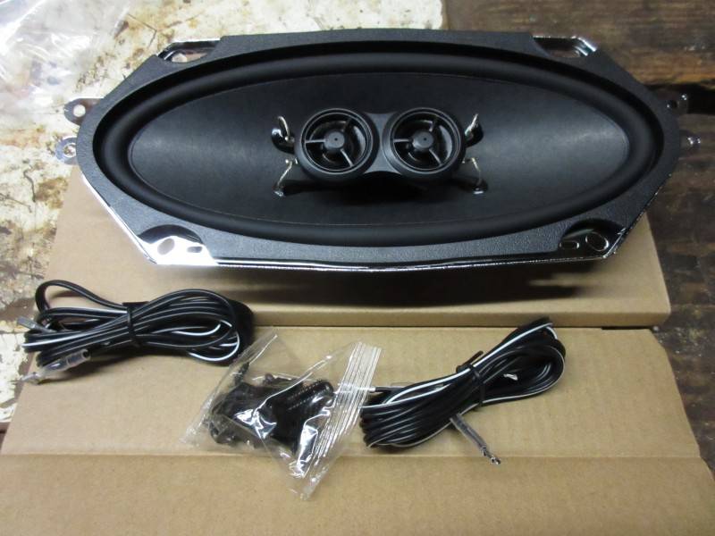

Dealing with my dash speaker years ago thought how nice it would have been to have 4 nice screws on the exterior of the grille. Those screws wouldn't have offended me at all. At my age now, hope the speaker lasts longer than I will.
That speaker will need minor trimming to fit the opening.

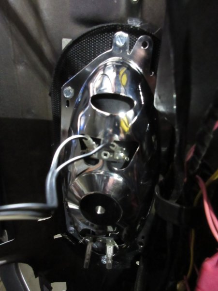

Is that the Retrosound speaker? Mine looked like it would need more than a little trimming to be installed on top of the dash. I screwed it on from below instead.

I installed the Retrosound dual voice coil speaker. I don't remember there being any kind of optional grill when I bought mine.
Center speaker is installed. I ordered Retrosound's speaker grill cover to keep the mice out. It took a lot of modifying to make the cover work, but it was something to start with. I'm happy with the end result, as long as it sounds good!
I'm trying to mount this guy into the 72 Charger without taking off the dash. I've got a cap on the dash, which overlaps the speaker grill and it looks like the grill can't be pulled without removing the dash. I'm pretty sure I'll end up removing the dash, but if I go that route I'm in extreme danger of "project expansion." If I have to pull the dash I'll end up replacing it with a repro, and if I take out the economy instrument cluster it may be a fancy one with a tach that goes back in, if that's possible. Probably needs a different wiring harness so you can see how this is mushrooming into a huge job.

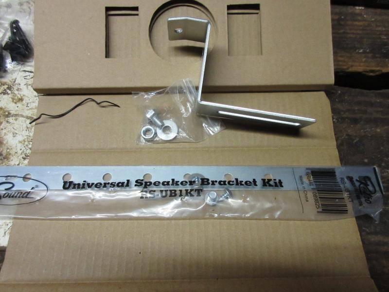

I bought Retrosound's mounting kit for this speaker, but I don't see how it helps -
What would that bracket bolt too?
Bolts to the Defroster Vent studs.
