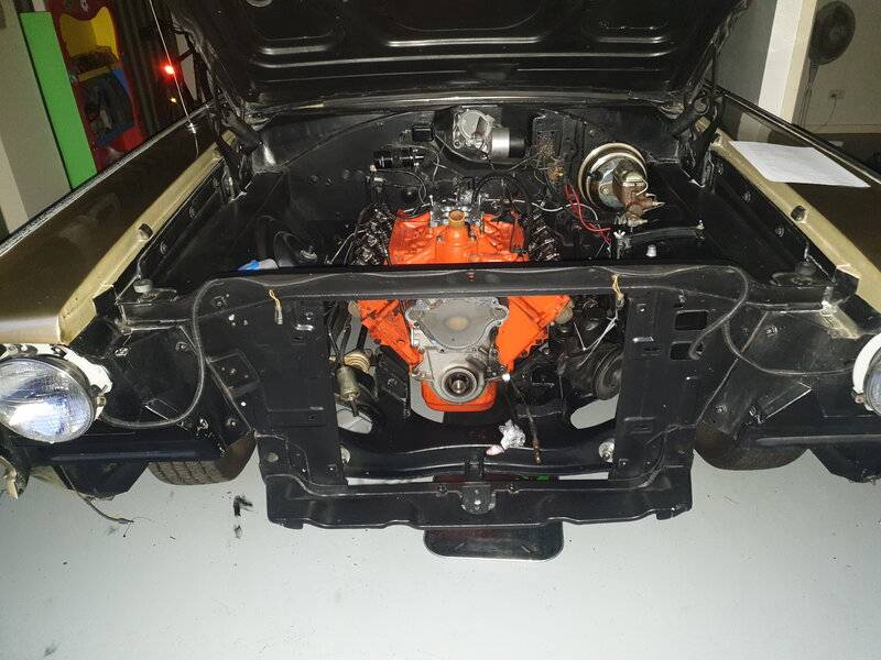

I'm putting a bigger cam in my 318 poly. I've paid people in the past to put new cams in my 318LA and a 351 Cleveland. Dropped the car off, picked it up all done. Now I'm doing it myself I realise what a big job it is ( to me). Hats off to you guys who change a cam before lunch. This is a major operation for me, I've had to take out the grille which necessitated removing the bumper. I'm about 4 hours in and I haven't even got the intake or the timing cover off yet! This is on an engine that was running perfectly. I sure hope I don't screw it up!

I'm getting someone to come out to degree the cam for me - I figured I would just do the spanner work either side to save money (and I enjoy it). It's going slow because I'm cleaning everything up and repainting while I'm doing it, and I'm working, kids etc. I might have to pull the hood off as access to the distributor is a real bitch, why they didn't design the engine to have it at the front like the big blocks I don't know.

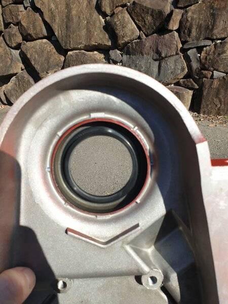

I put the new timing cover seal in yesterday and it looks like it's got a small area that's deformed. I've checked it by putting the balancer through it and it seems to be ok once there's outward pressure on it but I've ordered another seal and will probably fit that when it arrives next week. Shame as I was careful putting in.

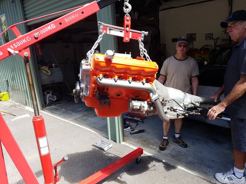

We installed the engine and transmission in a few hours. I've spent longer than that cleaning old gaskets off and cleaning and painting the water pump, timing cover, and valve covers.
