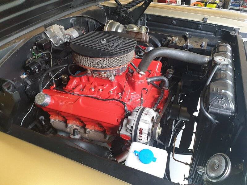

For anyone interested the cam is run-in and the car is back on the road! Longest cam change in history! Car runs great, not a huge change from the old cam in terms of bottom end (maybe just slightly softer), but much more free revving and less feel of inertia. I was 50/50 on whether this whole episode would be a disaster but it seems my mechanical skills are higher than my confidence. The only leak is a minor weep from the transmission cooler lines so I'll have a look at that tomorrow, but otherwise all good :). P.S. please forgive the black engine bay, I painted it first when the whole car was planned to be re-painted black, but then ended up keeping it citron gold.

They've always reminded me of inboard manifolds, not equal length but straight out and too the point! No clearance issues either!!!
