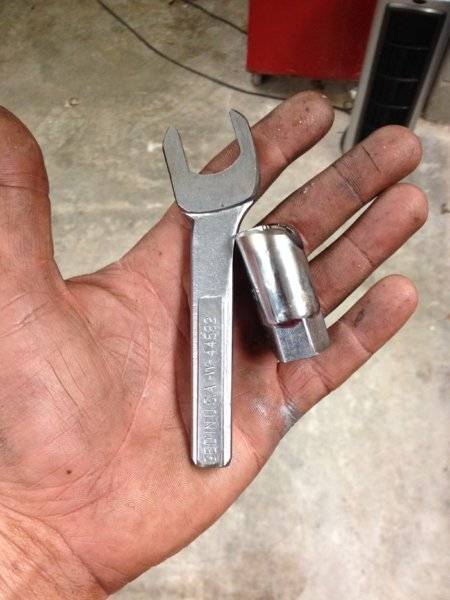

Here’s what I did...

I have to use a different tool or combination of tools for almost each plug. Of course a plug socket with the rubber inside. Different extensions. One plug I'll use a boxed end wrench. One or two plugs I'll use the plug socket with the hex to slip a boxed end wrench over that. A short piece of rubber hose that will fit the porcelain, works great after breaking the plug loose. Use it for installing the new plug also.

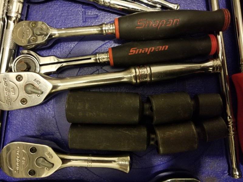

On my 63, with a 440 and headers, #6 and #7 will try my patience every time. The rest I can use my double swivel Snap-On spark plug socket that I posted above. I have been known to get so frustrated that I drain the anti-freeze and remove the passenger header. Along with a LOT of cussing!! :lol:
