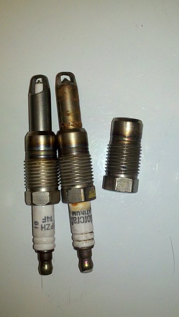

For any one with out a spark plug air adapter,here's a quick tip.
If you remove all the porcelain and electrode off of a spark plug and weld on a air line fitting in it's place it's a good cheep way to pump air into the cylinder.
Just weld both hex ends together to make the tool.It helps if you have a 90deg female fitting on your air line to connect them.I made mine years a go and it worked so well some one stole it lol.
