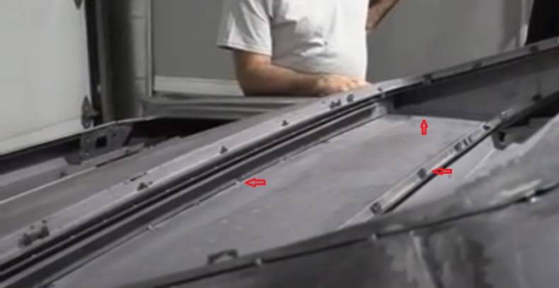

The dutchman panel stayed installed, the window plug lays over it. At the bottom where the bottom glass channel is there's a brace and that gets tact welded to the dutch panel. I've seen anywhere from 3 to 4 tacts. In refence to post #8 in the first picture

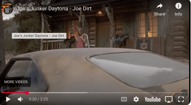

Joe Dirt was on TV last night and the scene with Jamie Pressley has a very good shot as it pans across the rear. It shows the curvature of the rear glass
I don't think you can use that as a good example, from several sources I've read so far, the Joe Dirt Daytona clone used a Vega back glass when it was built....a not uncommon practice.
