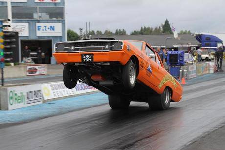

Need opinions on launch please, 68 charger, 3350 with driver, ladder bar set parallel with ground, QA1 singles in rear set on 2 clicks from full soft, dbl in front set on 2 rebound, 10 comp. 440 688hp, 620 Ftlbs. Launch on transbrake 3600rpm and it likes to spin, tried lowering tire pressure and no difference, tried raising and still no difference, tires are 29.5 10.5 m/t et drag at 15 psi. Hooks well on foot brake. Possibly hitting tires too hard on transbrake.http://m.youtube.com/watch?v=WBGRDKZsQsw
Is the front end coming up too fast, topping out and unloading the rear tire?
Ya I'm thinking so. When I launch on foot brake it launches fine and hooks. That makes it so the front end doesnt come up so fast. So maybe ill try tightning the front up on transbrake. Racing this weekend so I will see. Probably going to tighten the rear to. Might be basketballing the tire. I have a fresh set of Hoosiers to test out as well. Thanks for the input.
Kinda hard to tell, but it looks like it's spinning from the get-go...not just once the front end tops out. Better video available?
Looks like the front end is coming up a but quickly and topping out but like Herr said, the vid isn't the greatest. You have a lot of power for the size of tire so you might need to soften the hit. Can you lower the rear any? Have you scaled it yet? You might be surprised at how much of a difference just 1" of ride height can make in your front to rear weight bias. I had a similar problem with a car years back and tightening up the front shocks and lowering the rear did the trick.
It plants the tires hard but doesn't hold them there. The front comes up then stops and that's when it spins more. I would start by tightening up the front shock extension to slow the rise a little, then tighten up the compression to hold the front up once it's there and see how the car responds. It's transferring the weight to get up on the tire but not holding it there.

how much tire pressure? you need to tighten up the rear shocks a bunch more , so it can plant the tire harder. You can try tightening up the front if that doesn't work a few clicks.

15LBS. if that's a bias slick is a little oo much air pressure. I run 13 lbs. on a good track and 12.5 on a marginal track. you're spinning because of that pressure. hope this helps. don't tighten up the fronts, tighten up the rears some more.
Thanks For the advice. Ill drop the air pressure and tighten the rear shocks and see where that gets me.
