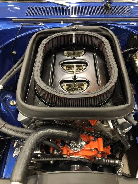

This is all interesting to me. My B body is a Hemi, dual quads, my '69 Dart has a 418 stroker small block, with a Sixpack.
It's a pretty well built street car. It will start nosing over with anything smaller than #66 mains and 6.5 power valve, that's on no alcohol premium. I am up to 69's now on reg 10% alcohol gas. The ends are at 79's (Promax plates) on the alcohol gas. My air/fuel idles on the ends are anywhere from 1/8 turn out to one full turn out, depending where they end up with a vacuum gauge, laser heat gun and finger over the air bleeds to detect a rise or fall. Purple or yellow springs. One of the biggest changes was mufflers. I have sensitive hearing, removed the open Flow Masters and installed Walker Quiet Flows, changed everything, bogs now and has never run again like the absolute monster it was.

Seems pretty rich on the mains when you consider the venturi area. I would start from scratch. Disconnect the vacuum to the outboards and get an O2 sensor so you can see what's going on. You should not need anything more than the stock 62 or 63 jets. Also note how strong your car runs on just the 2BBL. It will be better than you think once you dial in the mixture. Shoot for 12.5:1 WOT and around 14:1 idle and cruise. As lean as you can stand it on cruise but it should fatten up as you roll into it. Cruise mixture is adjusted by the IFR and /or air bleeds because you are on the transfer slot. I got the Quick Fuel metering block for the ability to adjust the IFR sizes. Power valve setting half of idle vacuum to start seems to work out well. Outboards will be a different story. Jet until you get 12.5:1 WOT with everything open.

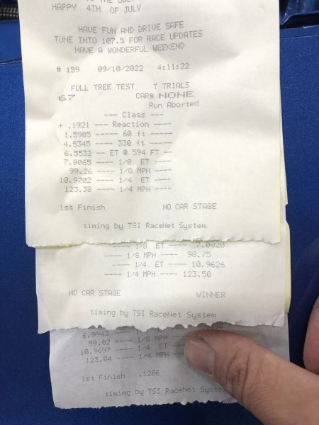

I’ve done quite a bit of testing with 6 packs as well. Every car and combo likes something different. I’ve ran them on everything from 14 sec cars to 10 sec cars. I agree with the above as I set mine up for best ET at the track with slicks. If your tuning them on the street to not feel them open, chances are there’s ET left. I’ve also noticed the big cube engines don’t really care all that much about the secondary opening rate with a decent gear and convertor. My 512 wanted them open right now, i ran the lightest springs on that engine before i went to mechanical carbs. It also had shitty distribution at low speeds. Something that typically isn’t an issue. Some intake work straightened that out though and really helped the low speed drivability. Although I was a little cringe worthy initially grinding on the intake.
This convertor is about a .10 slow from the previous convertor I broke. It was also 95 degrees and humid this day, so it’s got more left.
