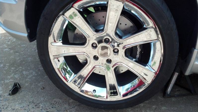

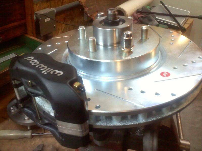

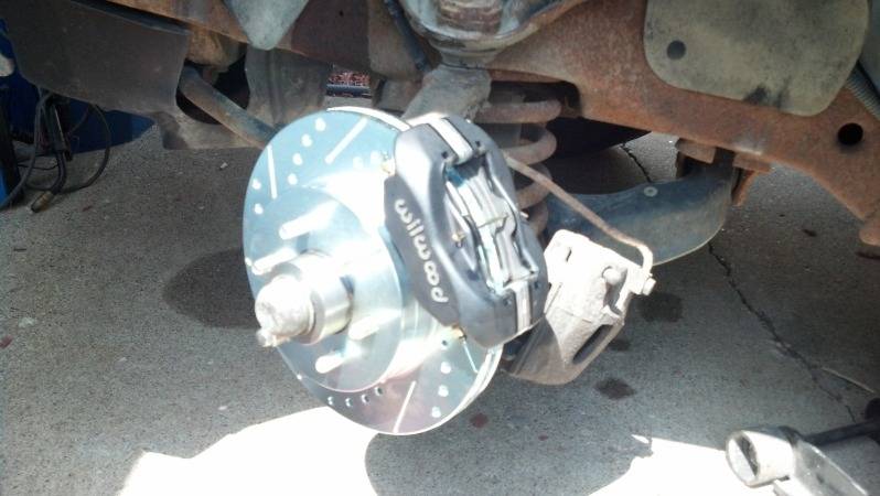

using corvette zo6 brakes

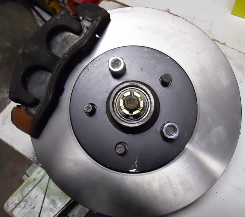

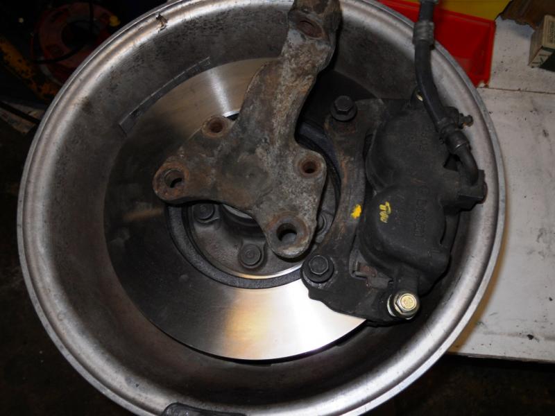

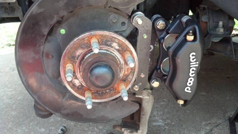

I went with 2005 crown Vic dual piston calipers on the drum hub/spindle with a custom 4140 bracket...The crown vic 12" rotor fits the drum hub with the correct bore in the rotor, I looked at a mustang and its too small to fit the stock hub. Its totally a bolt on deal, the earlier crown vic rotor is 12.44" and thicker but the hat section is too tall to work well. If you have access to a waterjet, I can send you a copy of the pattern for the adapter in Cad.
The rears are from a mid 90's explorer, they are the same as what the Jeep GC uses and can be put on an 8 3/4. All told 50 for calipers and brackets, 100 each for bosch rotors, 50 to waterjet the brackets, 20 for new wheel studs. The rears cost 80 from the salvage yard, need new rear rotors yet. Tim

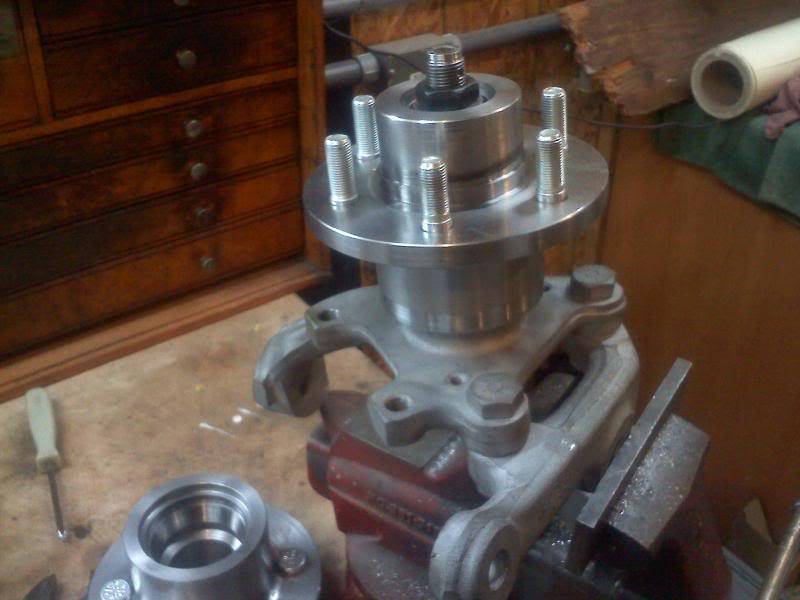

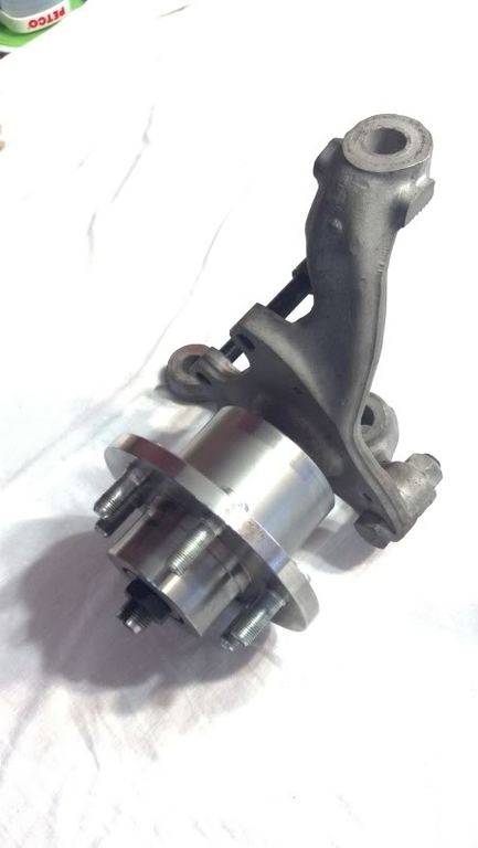

where did you get the hubs?
i made them. i have a full machine shop
